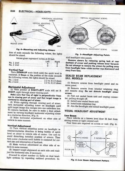

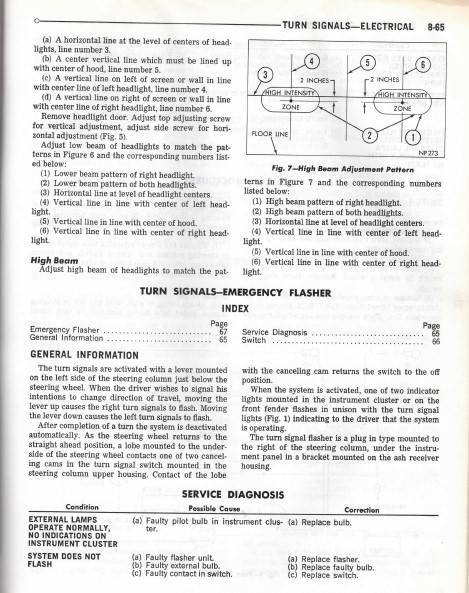

Here you go. Like others have suggested just shine them on a wall on a flat surface. I've been doing that for as long as I can remember.
