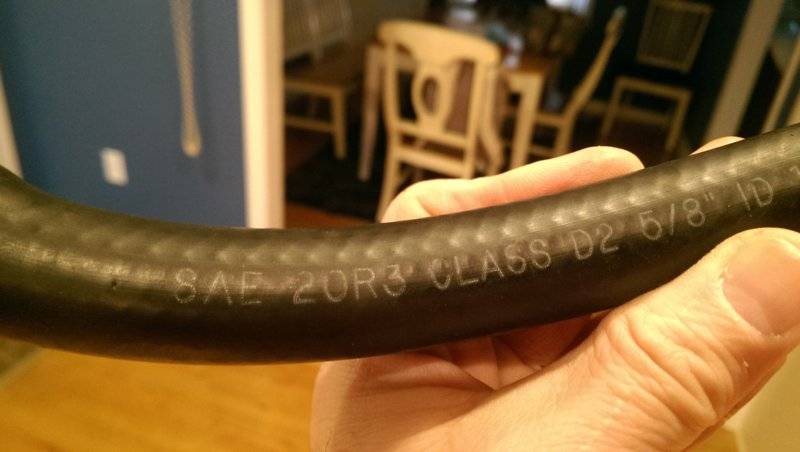

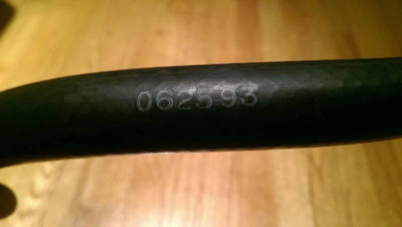

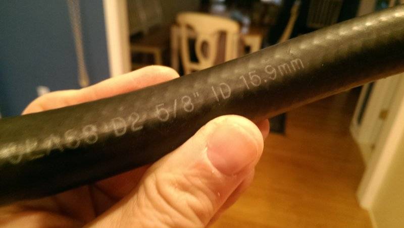

These are the hoses currently that are on the car. I seriously doubt these are original but thought I'd post anyhow. The PCV is 3/8" while the air cleaner is 5/8"
