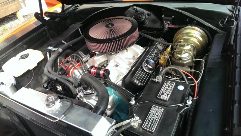

You can get a 1-5/8" drop base air cleaner from Summit and run a 2.25" tall filter. The whole deal cost ~$40. It fits on my '67 Charger, same manifold, same type of carb. It's not a lot of air filter, but it hasn't been a problem. You can get one of those K&N lids that have a filter built in if you're really concerned.
Like so!

More clear? Hey.. No biggie. I was just kidding around.
My air cleaner is the non traditional, Mopar common size, not the generic parts store 14" version. Regardless, the car runs tip top!
