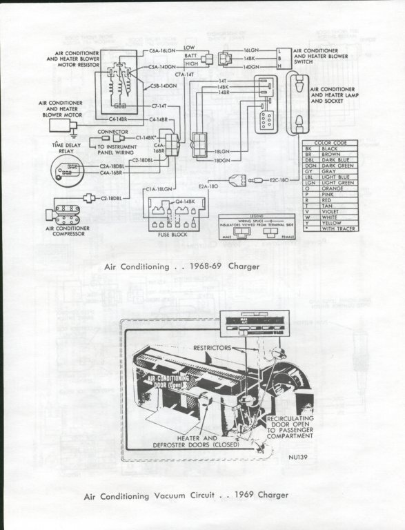

O.K. here is your theory of operation:
Key switch to on. Key on goes to certain circuits including the A/C heater control. When the A/C selector is activated on one side of the low pressure switch you will have power. Check that. If you have it good. Switch the selector to off and you will not. If you still have it your selector switch is not shutting off. Sounds like your heater control. You have good pressure in the low pressure switch that will keep power to the compressor when one side of the switch is activated. Which has everything to do to turn on the compressor. If the clutch is stuck to test simply turn the outer ring by hand to turn freely. Just trying to help. Didn't want to get in a pissing match. Having problem with my GTX A/C too!
This is for a 68-69 charger I can't imagine it would be much different than a roadrunner.
