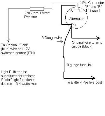

I pulled mine from a 88 Olds Cutlas cierra. Tha car uses a serp. belt, so I used a pully from another car with a V belt. I pulled everything I could from the Cutlas, it had several fusible links and a power junction. As for mountin I used the small block upper mount and a big block lower. I used this diagram to wire it in, and now I have 14 volts at idele with the lights on.
