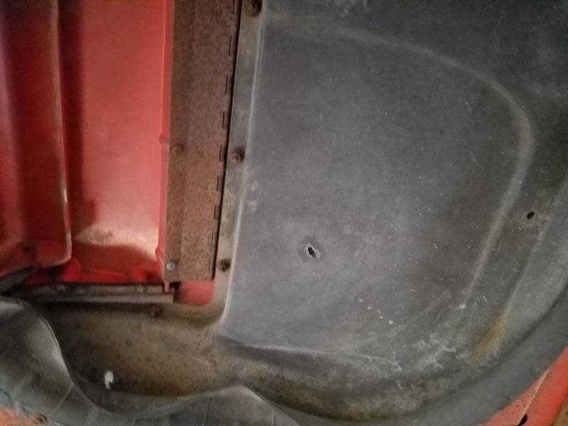

Here's a pic the large dark gray part with studs holing it on ,is there more than 1 clip besides bolts

All good, like I said that's why I was confused. Still unsure of your initial question. Are you asking why the fiberglass part wouldn't come off after removing the nuts under the door opening??? If so then you have to remove that one bolt in the circle section.
Just went back and looked at your picture, you don't have the rear bolt in so only other thing that holds it up there is the flapper mechanism.
Hope that helps

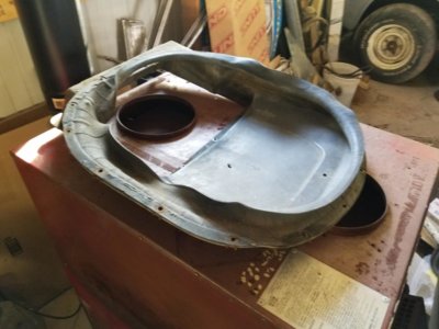

Took off flapper i guess just stuck I'll try find my heat gun
You disagreed with my answer and then a few posts down said you will be painting the hinge red along with your hood. Don't understand why you would disagree and then later kinda agree????
Hey how about the the covers on each end of rod are they supposed to be car color some I've seen were orange?
Got it off! Yes, thanks for help! Wonder if it'll help my stove breathe better!lol
Any suggestion on softening the rubber would like to keep original clean up and reshape!
