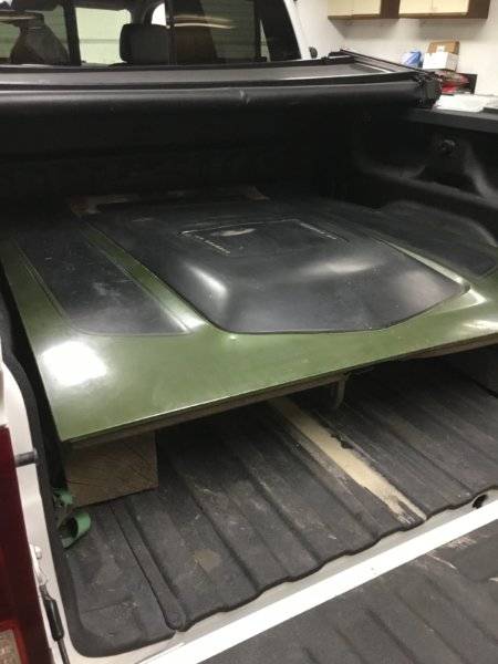

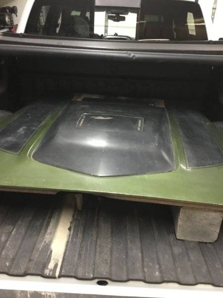

Just back from road trip to Battle Creek MI. Picked up a VERY nice complete ‘71 Air grabber hood.Rust free original paint with all the operating parts included.The three year search is now in the books. Got a great cash deal from Mario that sells parts in the Detroit Metro area.Great honest person to do business with.The hood was nicer than I expected.

thats great,glad you found it.:thumbsup:
Very cool. Patience pays off, and the good quality of the hood will live on long after the price (good or bad) is forgotten. Nicely done!
Great find!!

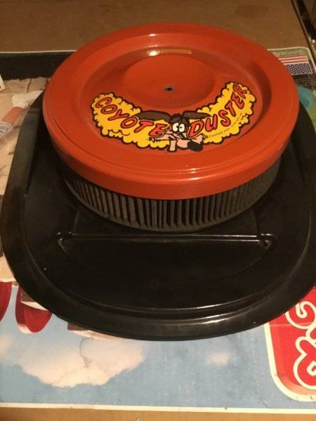

Picked up a nice air cleaner several years ago.Thought about selling it several times thinking I would not ever find a hood.
Glad now I never got around to it!!!!

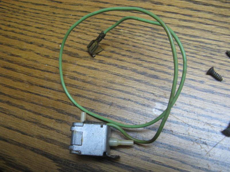

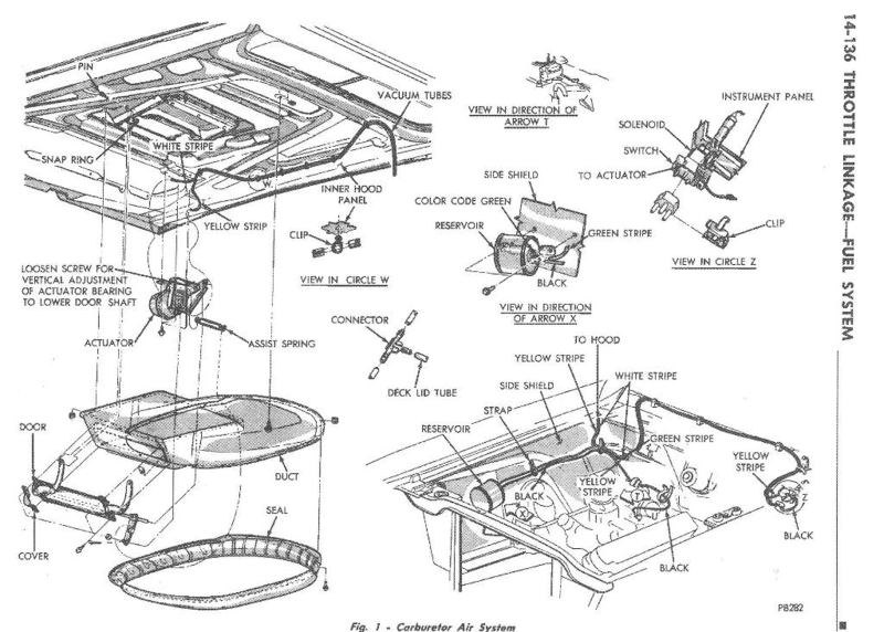

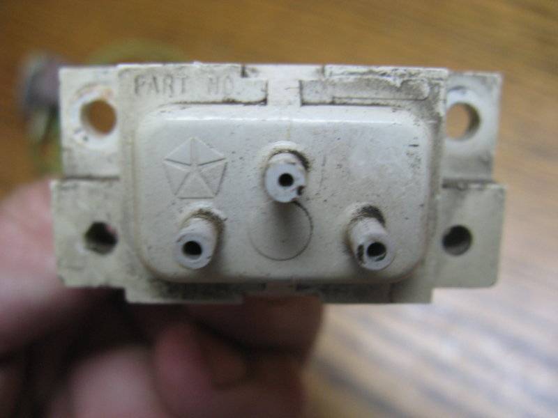

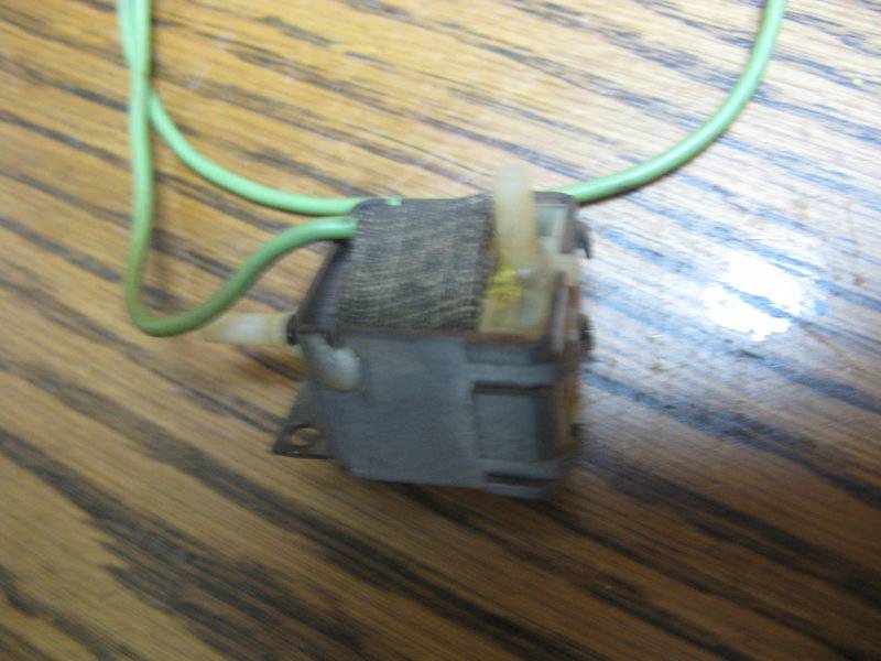

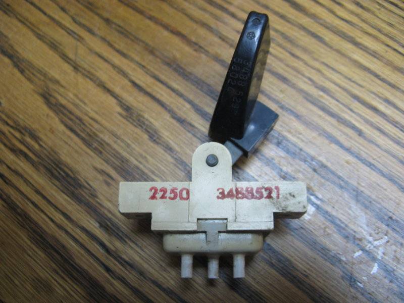

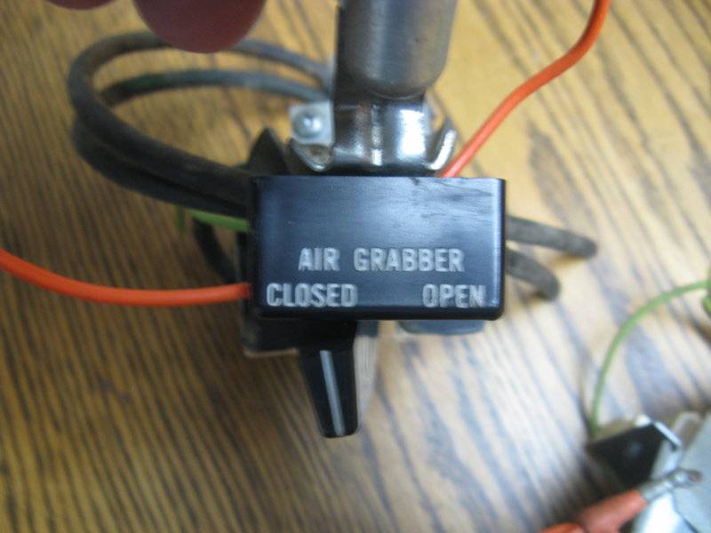

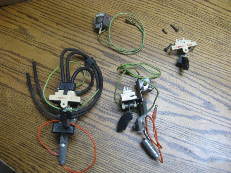

Hey Mike, Here is some pics of original A/G switch set-ups and some pieces. This is what your looking for. You can see the switch vacuum ports on the back of the switch and the part #. Those ports are important and should look just like that not all gooped up copper tubes in them... Also the solenoid you can see the vacuum ports on it there are 2. The loose solenoid is a 70 it just has a different wiring end compared to the male bullet type used on 71-2. The light brackets are easy to find as they are the same as the defrost switch bracket and wagons for the rear power window. Hope this helps you find quality original parts!!
This link will help you later once you start putting it all together...
https://board.moparts.org/ubbthread...298/air-grabber-hood-vacuum-line-routing.html
