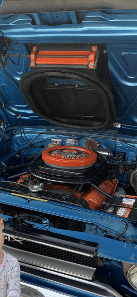

What is mounted on the bottom of an air grabber scoop on a 1970 GTX? There are six screws on the underneath side. Any help and or pictures would be great, Thank you.
Here my air grabber, which 6 screws?

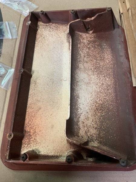

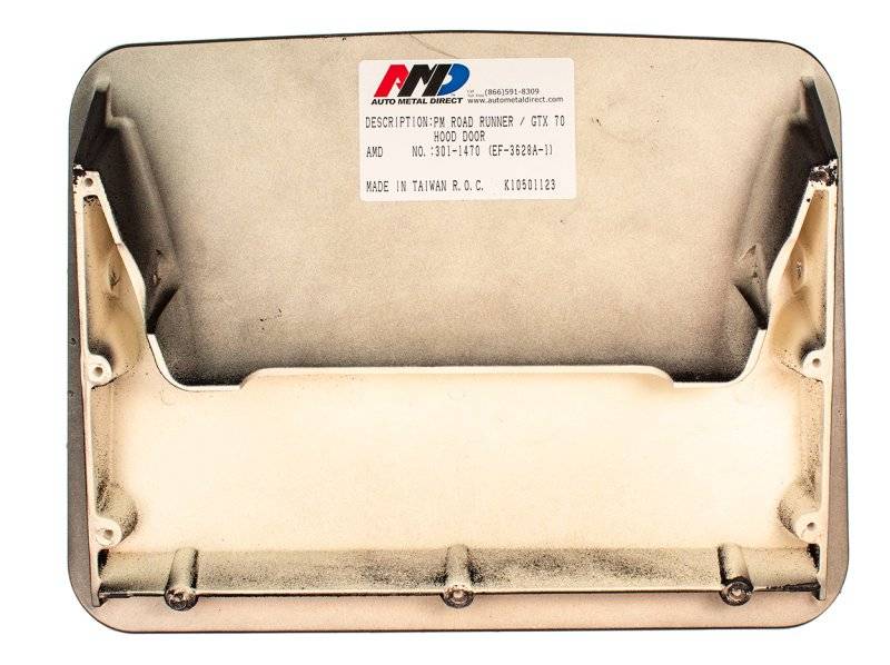

There are three screws on each side of the scoop. The other three screws hold the scoop to the hood. My original one appears to have rubber between the scoop and screws.

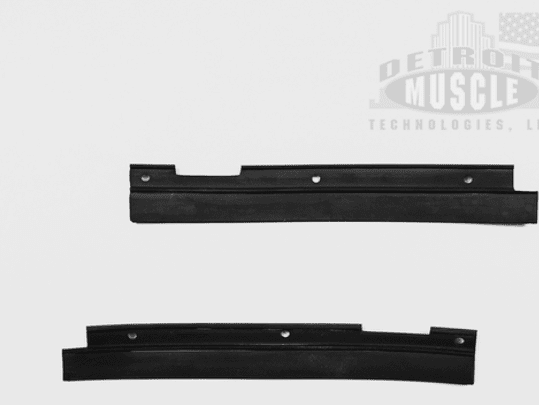

That’s where the strip seals go my friends. I’ve only seen one car in my life with them still intact but seals still available
I bought the wrong strips many years ago - there's a similar part used on another model air grabber system.
