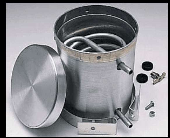

I found using a cool can (with ice) on my bracket racer removed the air/vapor in the transparent fuel filler completely.
