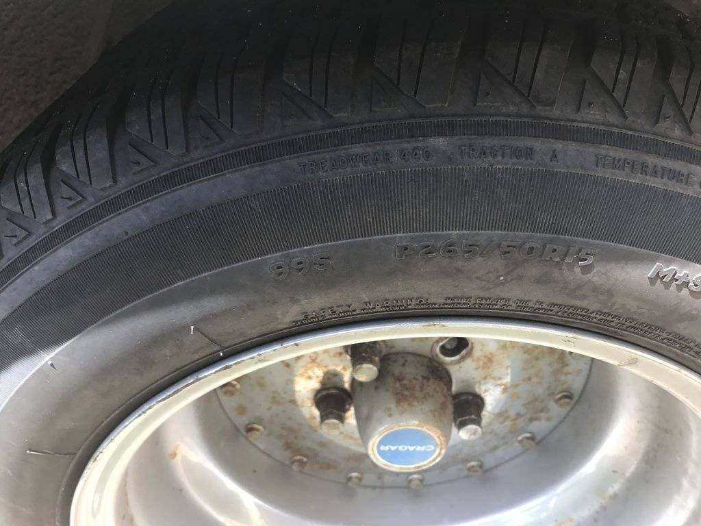

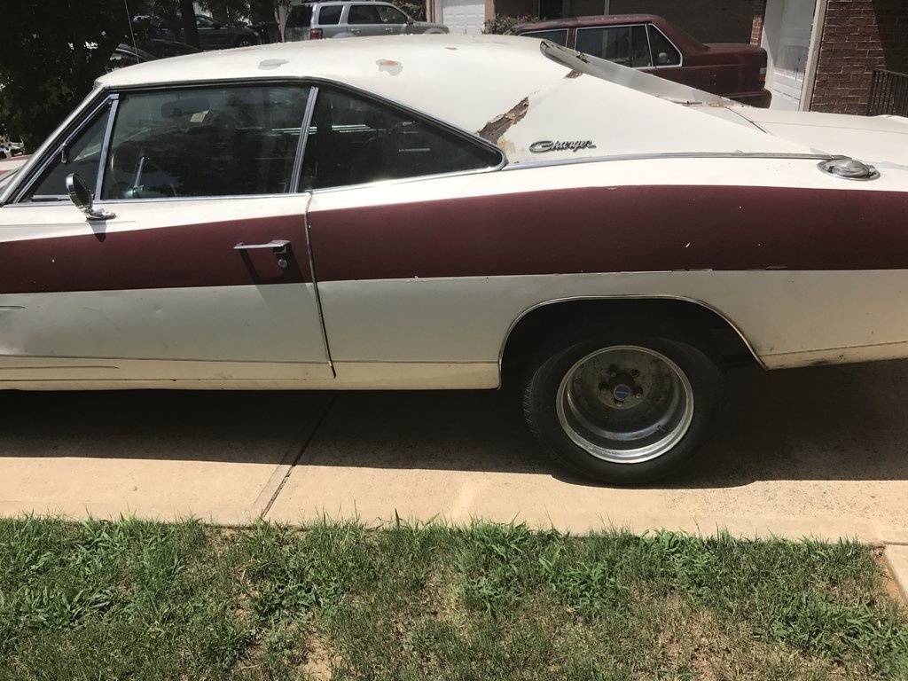

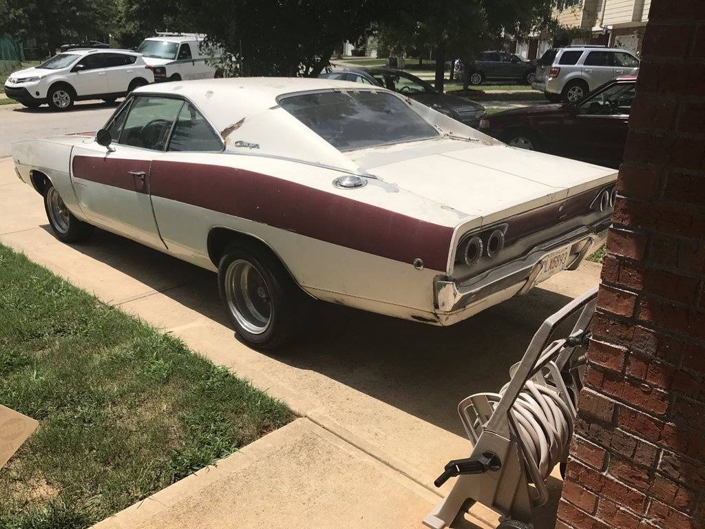

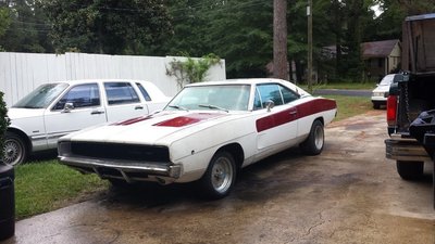

The 1st 3 was taking a sec ago and the last pic last year...at the moment I don't have any pics of my leaf springs or pics underneath the vehicle. I was thinking about getting new leaf springs whatever good quality reasonable shocks I can get without breaking the bank. She a work in progress on the outside lol just trying to avoid any major issues underneath.
