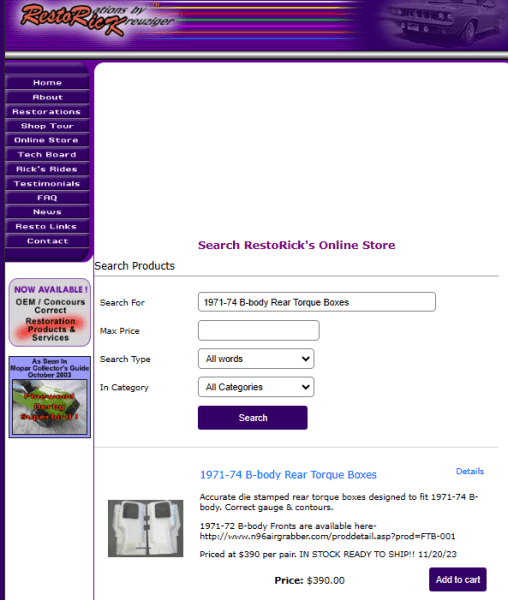

Resto Rick makes excellent front and rear torque boxes for less than Hotchkis.
I have them on my Runner.

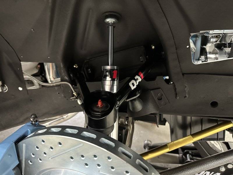

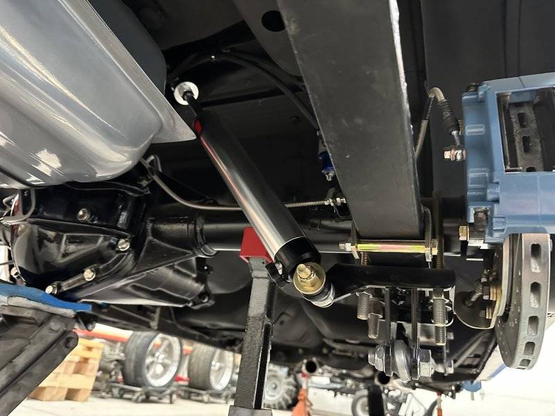

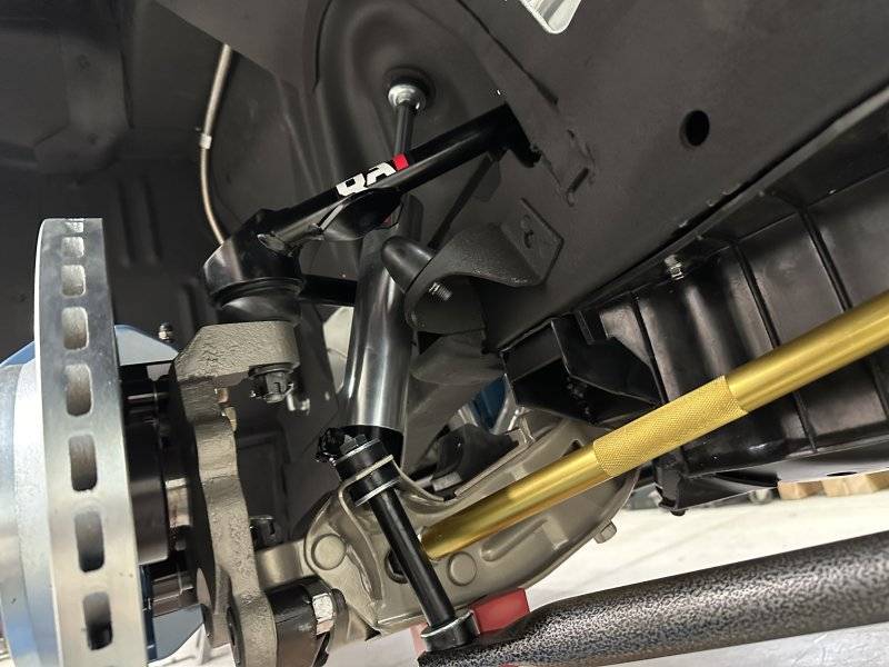

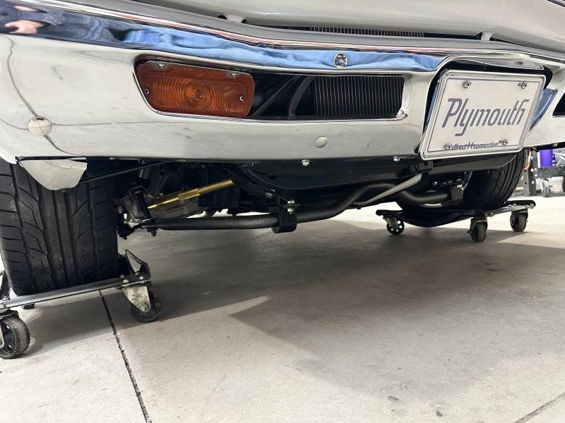

All of the above. Weld in frame rail connectors (USCT), torque boxes (USCT), Borgeson Power steering, boxed LCA's, QA1 adjustable strut rods, Firm Feel 1.06 T-Bars, 2" drop spindles, QA1 UCAs, Hellwig 1-3/8" tubular sway bar up front, none in the rear, Poly bushings all around, QA1 double adjustable shocks on all 4 corners, Calvert split monoleafs with Cal Tracs in the ***.
I put it all in together so I can't say what the most significant feature is. My guess would be frame rail connectors and torque boxes. Hooks and handles great.

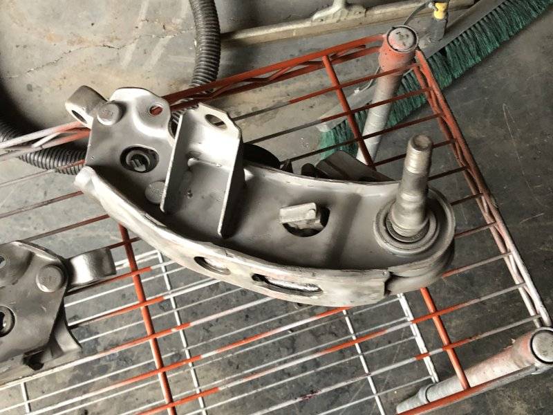

The LCAs are boxed....

View attachment 1789606View attachment 1789607View attachment 1789608View attachment 1789609
What benefit do you gain with the adjustable strut rods? I've already got the frame connectors, 1.1" torsion bars and polyurethane bushings so that's covered. I thought the Cal Tracs was more for drag racing, how do they perform in the corners and daily driving? You pretty much listed everything I'm looking at.

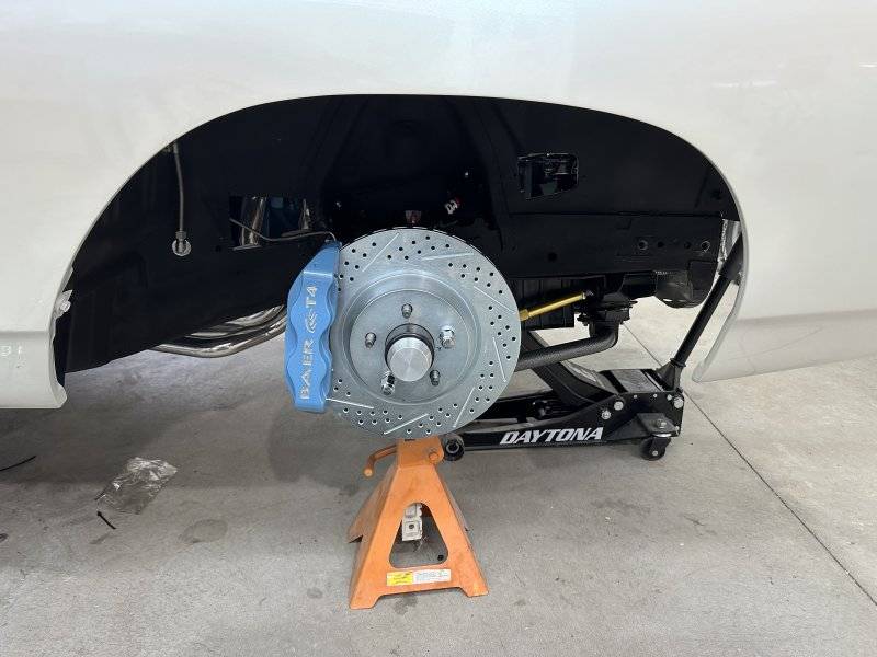

what brake setup did you go with, I might upgrade to disc in the rear while I'm at it.

As for the strut rods, my alignment guy said it gave him just a bit more of fine tuning to dial it in perfectly, plus they look cool :).

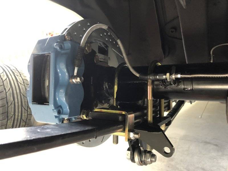

The Cal Tracs are pretty much a race thing. I like the split mono leafs because they are very clean, need to run the Cal Tracs with the split monos because they are too week without them. Excellent hook, almost too good, saves the tires a bit on the street if you like to play. Without them my 620 hp stroker would probably waste the rear tires in no time. Winding it up in first then dropping the hammer into second still leaves ~50 feet of stripes but it's very manageable. Not squirrely out of control fishtailing.

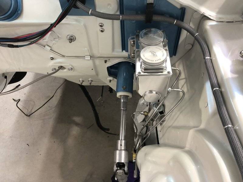

The brakes are all Baer from the master cylinder through the rears. SST4s, 13" rotors front and rear, manual. Smooth and big stopping power when needed.
