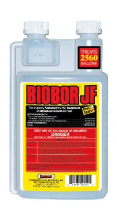

You need to look for a 'biocide' that will kill the bacteria. Mix it for a full tank, pour in,& add fuel to fill tank(& mix it up) let sit overnite to kill& coat interior of tank. If you have drains,drain a gallon or so of sediment. You'll still have to change filters more often for at least rest of tank. Then maybe some regular sta-bil after that. The bacteria grows faster in stagnant/unused tanks.

Talk to your fuel supplier. There is some stuff that you shock the tank with. After that you will need to put an additive in every tankful from now on until you are sure the **** is dead.
http://www.biobor.com/products/biobor-jf-fuel-additives/aviation-fuel-additives/
