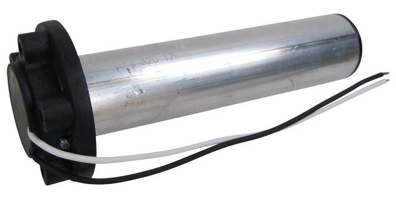

Today was a bit of a disastrous day for me. Yesterday, I pulled the fuel sending unit and discovered that is was a junk Chinese one that had replace the factory original. I tested it and realized it was a hopeless cause as the readings were vastly different than what they should be. I looked at the sender seal that was in the tank and figured I would install my new DMT one as that is best practice.

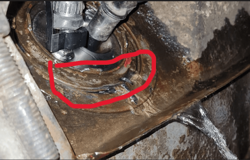

I have a proper tool, so no issues to reinstall. I did make a mistake though and did not lube up the lock ring. Fatal error.
It is hard to see there due to the rear end, but I felt it slide right back to the lock position. I figured for now, I will just live with the crappy sending unit unit I can find a good used or NOS factory original.

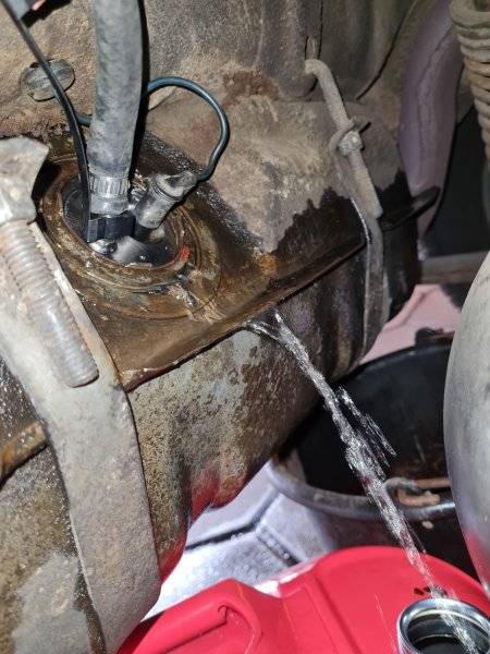

I started to fill her up watching for leaks and there were none. Just as I got the 19 gallons into the tank, fuel started to pour out of the sending unit seal. This is the worst possible situation. I am at the gas station and gas is pouring out all over the forecourt.
I was able to quickly siphon enough to get back down to a level where the leak stopped. After the dust had settled, I realized what happened.
The tank lock ring holder split, the full tank of gas built up enough pressure to push the seal out and the result was what you see above. Its the original tank, so I can say it's had a life.
