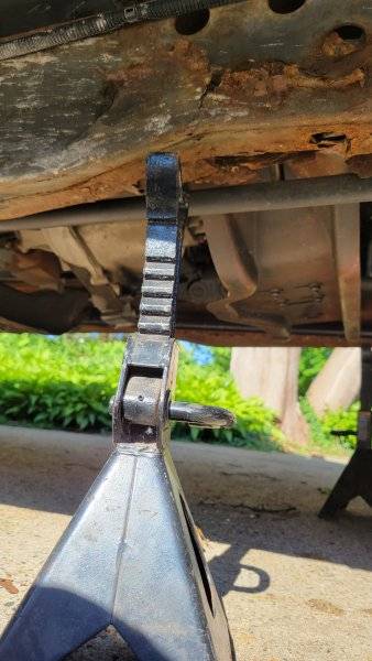

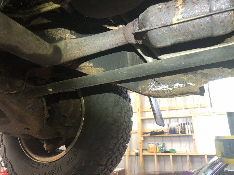

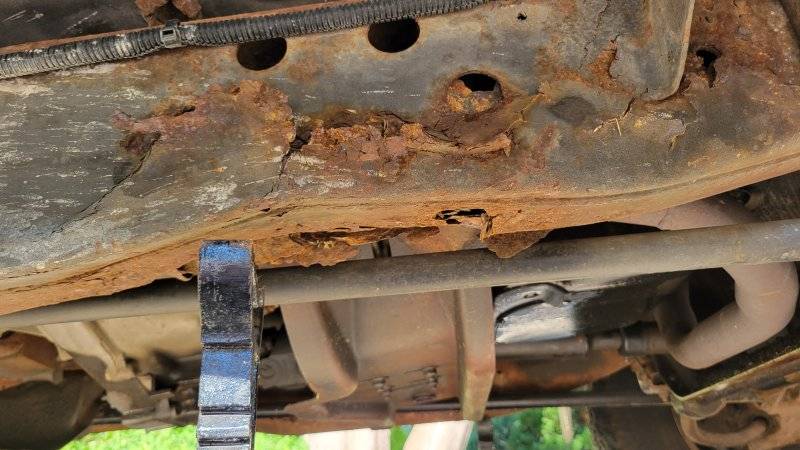

My 1996 Suburban. I drive it winters only here in NY. Rust and rot is going to retire this old girl likely very soon. Had it up in the air yesterday and noticed this. Inner frame on front passenger side.
Drive it? Retire it? I want to hear your guys thoughts.

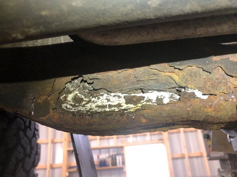

I think I'd move some stuff out of the way
and start grinding. If it's rusted all the way
thru just on the one side you may be able
to fish plate it well enough for the fix to last,
if the web of the outer channel (on the inside
surface) shows very little to no rust.
I've fixed Jeep frames (boxed) in similar
states of rust thru.
I wouldn't leave it alone - it is between the front and rear wheels where you will have a lot of force on it.
I agree with others above - put a patch on it. It can be ugly as heck; it just needs to be solid.
Good luck!
Drive until it drops. I about ran the floor jack stand through my rail. Been looking for a better truck for a couple months. Now is not the time to buy.

You might have to grind a ways fore and aft to find good metal to weld to. That was done on my 2 wheel drive truck. It was a ugly patch.

I would take a chipping hammer to it and see how easy it is to poke holes and knock all of it out. As long as one of those patches span the rot, it should be good enough and give you plenty of time while you watch for a different unit.

I will definitely start by chipping away, no doubt. True test of what I actually have for structure...
