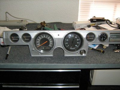

You can easily install the electronic circuit board into your existing tach if you're at all handy with a soldering iron. It also helps if you're not afraid to get in there and do such things yourself!
Your speedometer is only an issue when it comes to the actual cable or gear installed in the transmission. It's mechanical and simple. Those are the only two issues I can see for it to be jumping around.
Your ammeter should work. It's wired directly to the battery and alternator.
Your other gauges are connected to a circuit board and gain power through a voltage limiter. I recommend updating your limiter to electronic/solid state through:
RTE
Tach boards are also available here...conveniently enough!
If you decide to use any gauges from Charger Specialties you'll have to use their voltage limiter. Ask me how I know! Charger Specialties

Thx Lionized,
Looks like your dash was in a worse state then mine, visual wise.
I have a soldering iron and have done some repairs in the past so i will be able to get that stuff installed myself.
Noticed that on the before pictures the gauges are kinda yellow instead of white, where you able to clean that up to get it back to clear white?
After a good clean up that yellow will come off?
I will reconsider i think and buy a voltage limiter and tach board as you mentioned, i also will need new light bulbs i guess.
The speedometer cable looks new actually so it will most likely be the gear then.
I need to find a new drive gear for the speedometer, i did a quick search on Summit racing and Ebay but did not find any assembly's. (believe the drive gear is plastic?)

I refaced the gauges using decals:
Premium Dash Decals
I believe you can find speedometer gears through Classic Industries. You'll need to know how many teeth the gear is, however.

Is your speedometer close to correct now? If it is your gear is close or correct. If you go aftermarket electrical then you would not use a speedometer gear, just a sensor. Also the current pricing makes it harder to do minor corrections of gears.
To be honest I have no clue if the gearing is correct.
The speedometer is jumping all over the place at any speed.
Another difficulty is that I am trying to compare the speed with other cars in MPH, while I know the allowed speed limit in km/h. :)
I will check first what the condition is, if it is obviously damaged I will replace it with same size that came out and then I can check for accuracy.
The cable looks fairly new but I have not removed it yet so you might be right.
To me it looks like the issue has been there for some time already and tried to fix it with a new cable.
When I am back home I will pull the cable and gear and see what I come across.
It's easy to pull the actual cable out of the housing. Look for rust, and at the ends of the cable for condition, including the gear end, to be sure it's not slipping. Should be lubed with graphite powder.
