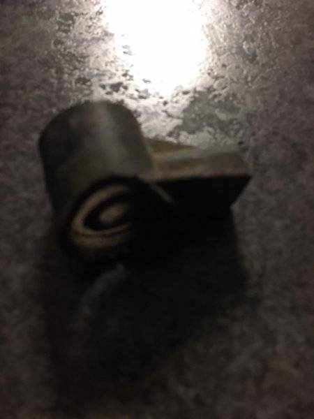

the battery side "wire shield" is broken. Do they sell this piece?
Is this shield-like piece even needed? I..e. Can i simply hook the wire direct and not worry?
I'm sure it's there to protect from accidental ground outs?
bad photo, so I can take another, but this piece. the wire is broken off right at this piece making it worthless

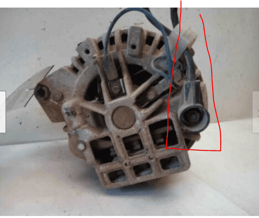

Yes that would. I forgot that that piece is a part that’s on the alternator. Not on the wiring. Sorry for the mid information. Kim
no.. I think it is part of the wiring actually. I found a complete wire harness with this piece but cannot seem to find the lone wire for sale.
Although... that last link i shared shows it as a stand-alone part. So.. it I guess it goes either way.

Can’t agree with that statement, if it can happen, it will and has many times no doubt. There is a reason the factory went to the expense to mold that guard to the ring terminal at the alternator stud. Put a boot on it.
Can’t I simply use the original piece still?
I can fasten the wire and slide the part over that ... then tighten with the nut?

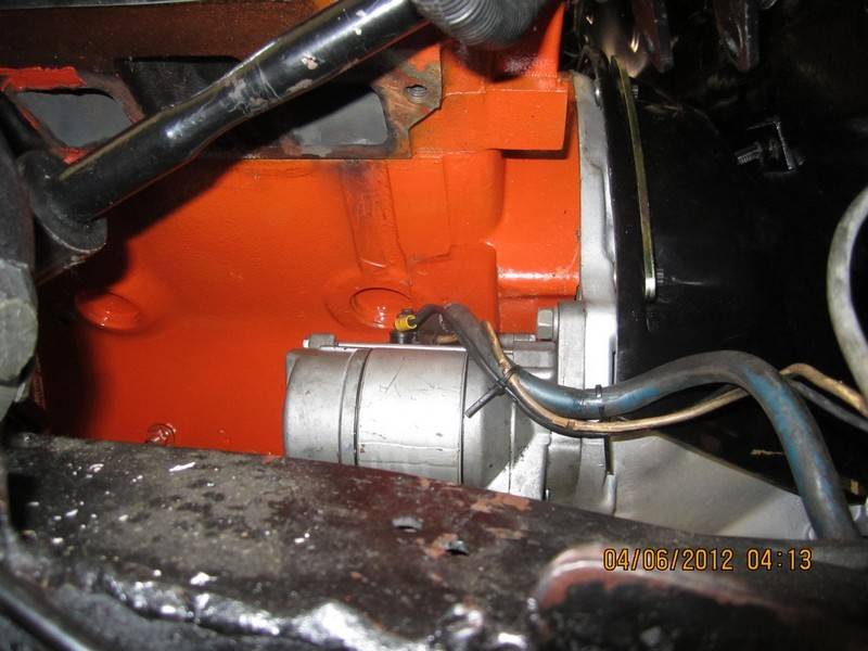

I had to remove the plastic add adapter off the mini starter for it to fit........25 years ago:D

The original guard is injection molded around the 12-gauge ring terminal, not easily removable. I’ve drilled out the cut off ring terminal to accommodate an up-sized 8-guage wire/ring terminal. Can be done with some effort.
The replacement option ( which has being posted )if you can't get the piece molded into the wire ( pigtail ) is an add on already posted which gets provisions ( the notch ) to be inserted with the eyelet terminal on wiring. Is not molded as mentioned, but keeps in place with same alt stud nut and eyelet terminal on wire. i have it.
