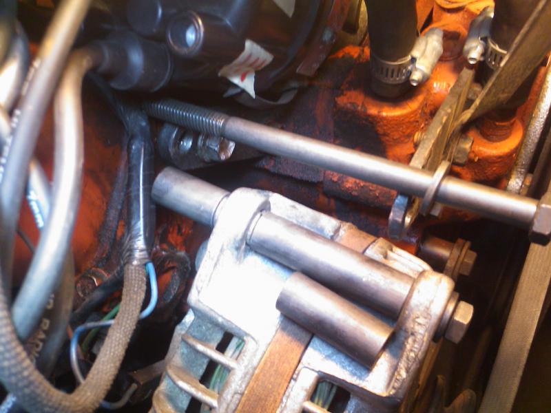

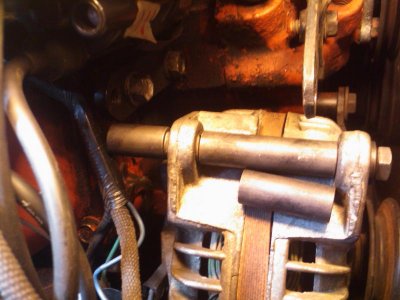

Hi there!
I was going to buy the alternator pivot bolt..(mine was missing, had just bolt and nut..)
Ordered it from Year1, got it and it didnt fit at all, whats wrong..?
I got two bolts, three spacers, but I figure that I just need one bolt and two spacers..
The car is a non AC, at least thats what I thought.., could it be that someone has mixed the brackets, AC/NonAC etc please help me sort this out!!

Try going to the Bouchillon Performance website and look at the pictures of the alternator mount for your car. They sell complete bolt kits and you should be able to find the one that shows your setup. I had a heck of a time with mine as well...
Greg
You do have A/C brackets pictured there.

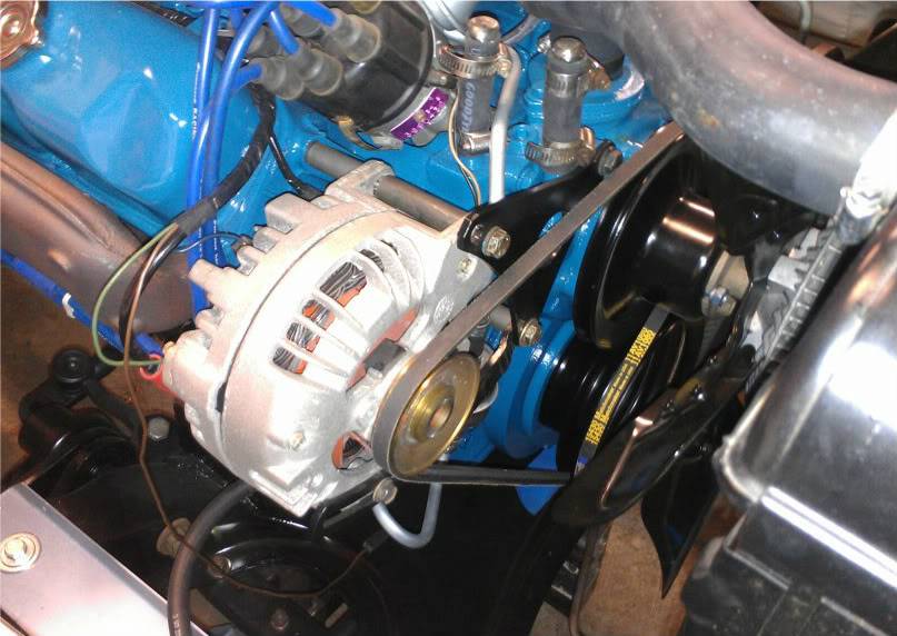

Here is the non-air bracket, bolt, and spacer configuration.
Thanks "72RoadrunnerGTX" then thats the bracket/bolt I need! Do you know if the waterpump/pulley is the same or do I need to change that to?
/Linus
