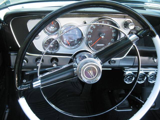

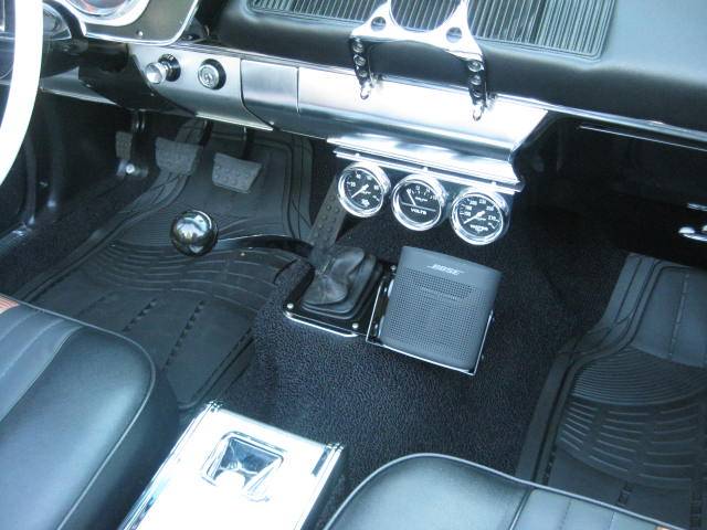

I have a 1963 Plymouth with a 440 engine. The other day the engine stopped running. come to find out the battrie went completely dead. I put a loaner battrie in and it started the car back up. Here is my problem, While going down the road doing 50 mph at 2000 rpm, the alternator needle is going rapidly fast back and forth from discharge to charge, and also the volt meter is running at 15 amps. 1500 miles ago I installed a new rebuilt alternator. The alternator gauge acted the same way even though the alternator was new. Please help.

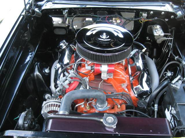

OK after removing the voltage regulator, I removed the paint on the bolt hole surfaces. This made a big difference. The alternator gauge needle shivers a little towards the charging side, and the voltage meter go's back and forth to 14.2 to 15. what do you think? Thanks again.

The old mechanical regulators pulse the alternator, but if voltage is still on the high side, make sure all the grounding is good. Battery to engine AND body, and regulator to body (or jumper a ground wire direct from regulator to battery ground.)
Also, double check alternator output voltage, and the voltage at the regulator. Ideal, they should be the same, but the regulator (ignition circuit will be just a tad less.) If the regulator hot wire into the regulator is less than the alternator (by more than 0.1 volt) , check the Ignition wiring for resistance / bad terminal connections.
