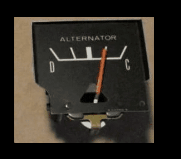

1965 Dodge Coronet Alt gauge needle shows overcharge at high RPM
finz68
Active Member
10:32 AM
Jul 9, 2022
40
12
bayville, ny
The battery on my 1965 Coronet is only a few years old and is on a trickle charge when parked. The Alt gauge is right at TDC at idle but any increase of RPM the needle stays to the right (similar to attached pic #1). After checking, the alternator is charging above 15v when the engine revs. Some car show buddies suggested that my voltage regulator needs replacement but I should get an adjustable one, not a stock replacement. Any thoughts? Thank you!

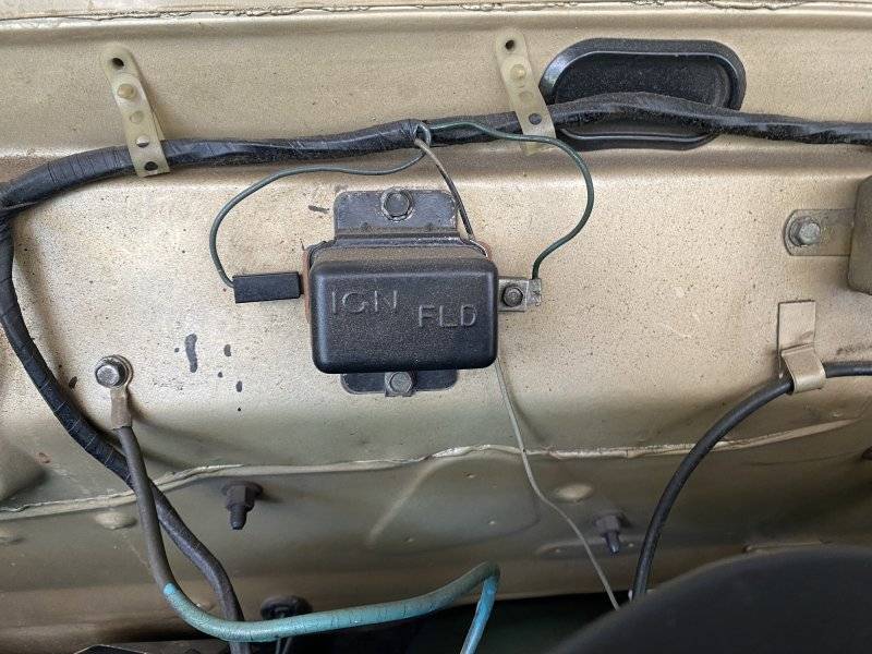

Is it a mechanical or electronic voltage regulator? Some (most) of the electronic regulators overcharge in the 15 volt range. But may not necessarily be a voltage problem.
Actually 493 Mike makes a good point. But does it have a stock, round back alternator on it?
I like the squareback alternator and a solid state regulator.
You only need to run one more wire.
Those old points style voltage regulators don't do real well.

B4 looking for "overcharging" issues, are you sure of the calibration of the instrument?? Not sure you know because there is no scale to say how much if any overcharging condition exists. Just because there is a needle's movement on an uncalibraed instrument The instrument is just a visual indicator not a quantitative device...no scale....IMO....just replace the mechanical voltage regulator with a solid state device that resembles the OEM.....or spend hours looking for bad grounds, corroded bulkhead connectors, loose wiring, parasitic connections.......
