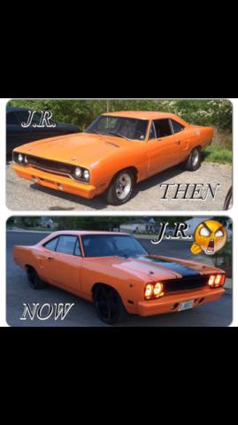

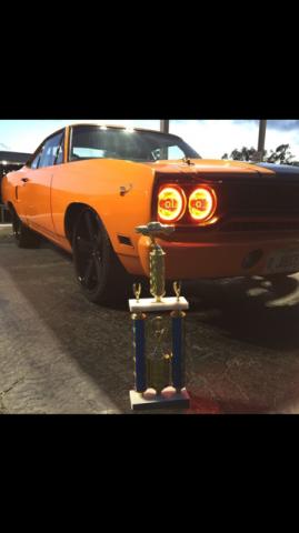

I have a 70 Roadrunner I named J.R. (not junior) with a mild built 440(wasn't matching numbers when I purchased so I did a pro touring look)with a lot of mods. Music, Halo lights, HID lights, etc. I had my factory alternator rebuilt to 200 amps. I have a battery for the car and a battery(both in trunk) for the music but for some reason the alternator is not charging the battery. I have a 4 gauge hot wire running from both batteries to back of alternator. I have replaced the regulator twice and just replaced the ballest resistor. I know the regulator is notorious for going out on a regular but is there a way to eliminate the regulator and ballest resistor? I'm sure i'm missing something but I have to start somewhere. Is there an expert out there that can help?
