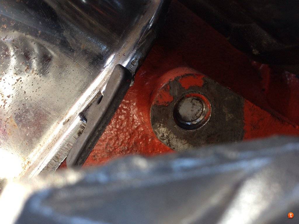

Bolt has snapped off in head.
Not much room to work, maybe an angle drill.
Luckily, it snapped off clean. Just worried that it will be impossible to get a drill bit in the broken stud if it's hardened steel....
How did it break? When tightening? Or from vibration? The lower bracket with the adjustment slot should have a piece that attaches at the motor mount for support. If it went in ok and the threads are not crossed it will come out fairly easy.
You need to get that alternator out of the way.Start with a small drill bit and center drill the broken remains.Then use a lefty drill bit and many times the remains will come out with the drill,if not the extractor bit is next:icon_batman:
before you go crazy with the drill, if the bolt was not bottomed out in the hole or rusted, you may be able to walk it around with a small punch and hammer. There is usually a high point on the broken bolt in the hole, be delicate, use it to get a hold with a pointed punch(sharp) dont go too close to the edge as to not stake the broken bolt on the threads, good luck, If not able to walk it out then get your drill and easy out.

It snapped clean. I may be able to punch a divit off center and try to carefully "walk" it out.

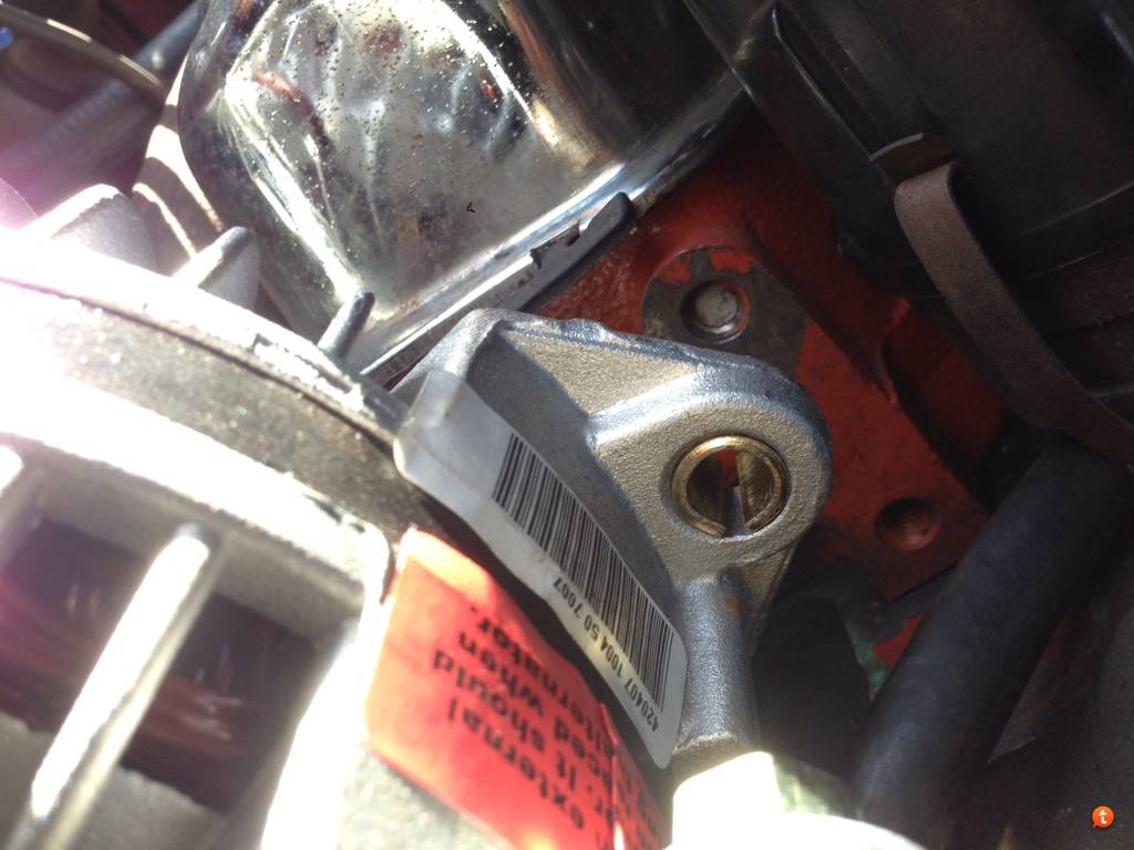

do you have the spacer that goes in the back?

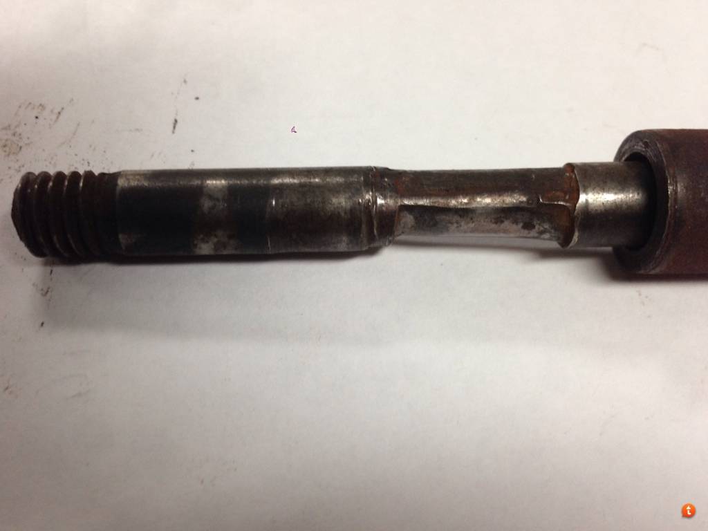

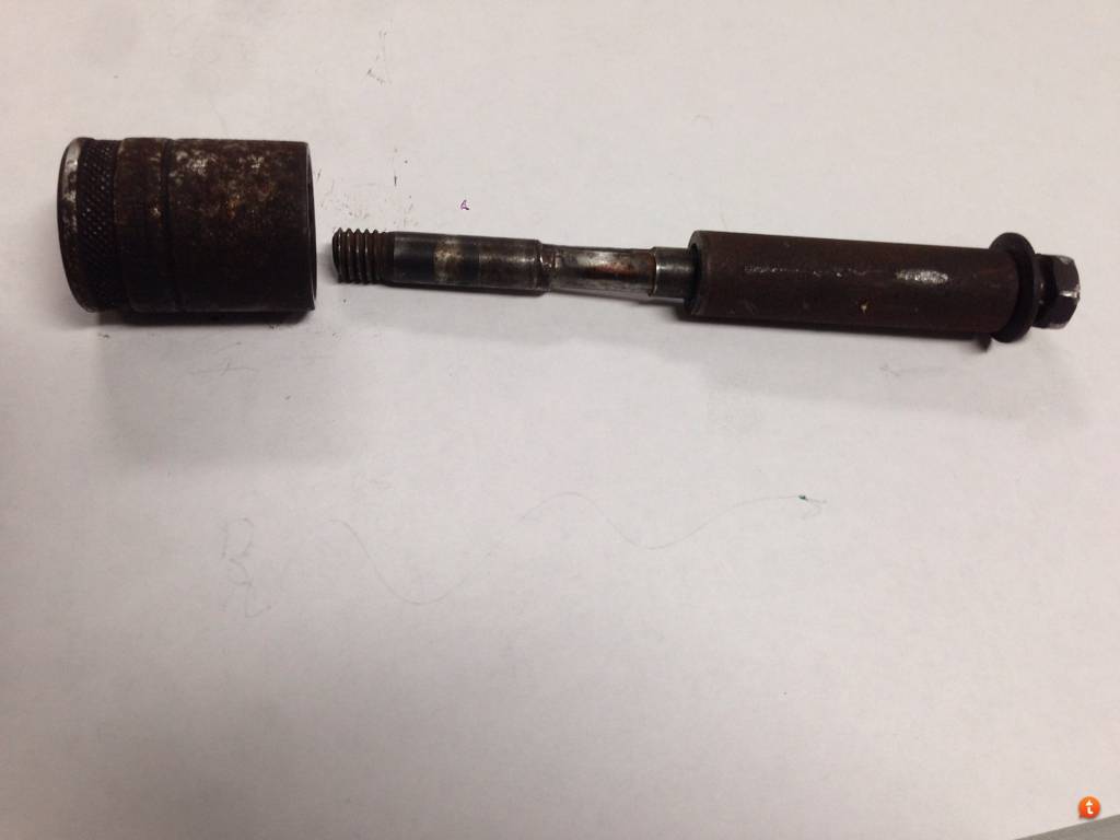

At least it's an actual car part, just noticed this:
"spacer" on my alternator assembly yesterday.
Previous owner prolly wound up with a MoPar spacer in his Craftsman socket set...
Also see there were wear issues on the through bolt, looks to be the spot the back "ear" of the Alt rests...
If anyone has a source for new bolt and CORRECT rear spacer, I'd be grateful....

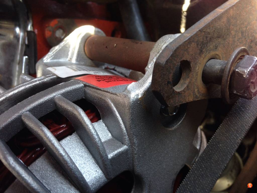

I think The spacer in question is the one between the mounting ears that should be caught by the slider of alternator. It is pictured in you other picture with parts, next to last on post#7.
edit: which I now notice has broken bolt, so it was installed. I and others have made this common mistake(missing spacer).
Seen this done before if you have the room center a nut over the hole and weld thought the center of the nut and weld the stud to the nut and wrench it out.
just get a left hand drill bit and start drilling. it will walk right out if it's not bottomed out in the head
Left hand drill bit and a use the end of a small file in that hole... if you go the welder route ground it close to the hole or the current can magnetize moving parts so they will attract iron particulate out of the oil as it circulates and damage bearings when current arcs across the surfaces looking for ground.... I would avoid welding on the engine unless all.else fails.... run a tap in there after to clean up the threads.
A spacer made of brass was factory on early cars till they switched to the split steel spacer.... know someone with a lathe?

I don't want to reveal all my secrets but .... if you use a bench grinder and smooth off the threads on the bolt you may be able to use it like a screwdriver if the bolt broke with enough lip to catch each other... same as a pick or awl mentioned above... while we're skinning cats

IMO, to break that bolt off there and if it will not turn with an awl, it's likely bottomed at the end of the threads in the tapped hole and will need to be drilled out. Very important to center punch the broken off part in the center! You may have enough depth surrounding the broken end to use a transfer punch to help you stay centered. The first drill should be around .125" diameter then you can increment up from there whether it be a standard or "left" turning bit. How straight and on center you drill that first hole will dictate where the next size drill will go.
