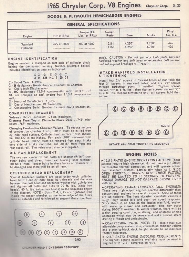

Searched for about an hour for this info. No luck. Anyone know the torque value for the 16 cap screws that secure the crossram intake to a set of Aluminum Stage V Hemi heads? I suspect it is an in/lbs value.
Hope this is what you are looking for:
Wait...wasn't your motor all done? What's up?
So then as I understand you follow the procedure on the chart and run them all up to 8 foot pounds - is that correct?
So then as I understand you follow the procedure on the chart and run them all up to 12 inch pounds - is that correct?
No, middle 8 ("B") go to 6 ft/lb, and the outer 8 ("C") go to 4 ft/lb.
Yup! Exactly what i was looking for!! Thanks a ton 69Bee. Is that a page from the '65 manual or a tech bulletin? If so what is the number, if I may ask.

No, it is a page from my "National Service Data" Mitchell Manuals. I have 65 thru 76.
