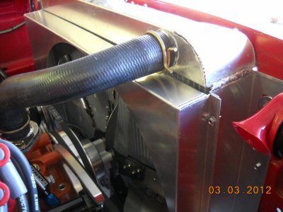

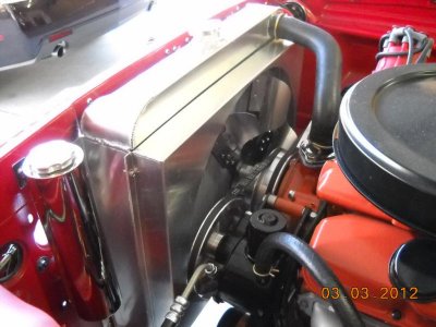

I bought my radiator and shroud from Mancini. More expensive, but they emailed a specification sheet that I filled out and got a custom made set-up. It fit great and keeps my motor at 190 and under (180 thermostat). I'm running a 6 blade stainless steel fan from them as well. The summers here are regularly in the 90s and 100s.
Love your setup, Dave - looks great, with the power steering and everything. I think I will try the radiator+shroud from Champion, and maybe upgrade the fan as well, as suggested. I guess a quick look at Mancinis´ first wont hurt...............!:grin:
