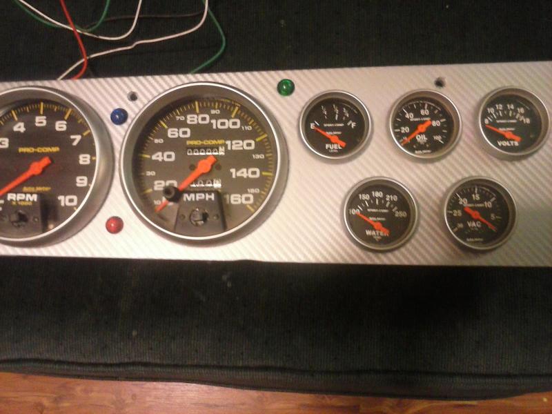

CAM00100.jpg I got my aluminum from a scrap bin where I formerly worked. Traced out my factory gauge panel, cut it with a jig saw & hole saw, then put my gauges where I wanted them. At first I polished the aluminum but later purchased a carbon fiber vinyl overlay. Total cost: aluminum $0, vinyl overlay $10, gauges $450. I plan on replacing all my wood grain pieces like this.

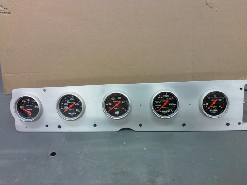

I cut a piece of flat aluminum and used the stock bezel.

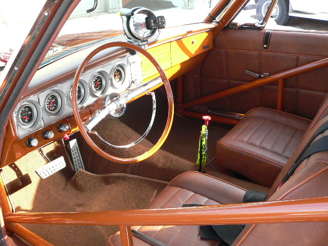

what kind of car ??... with a Mopar you will probably have to fab up your own...
