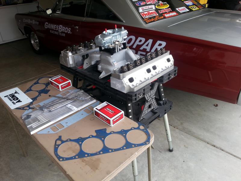

Call INDY CYLINDER HEAD and tell them the motor and cam (specs) that you have and tell them you want their SEZ "kit" which includes assembled heads, pushrods, Valley Cover, Head Gasket and Manley Head Bolts. Tell them if you have adjustable rocker arms or not. The springs that come with the kit are only good for max .600 lift cam and probably hydraulic lifters to be safe. If you have a solid lifter cam absolutely purchase an upgraded spring with the kit. Then, have a MOPAR shop do the installation (not a shop that has just worked on chevys and fords). The pushrods that come with the kit have NOT been sized for your installation and have to be cut down to correct height and then the tips pressed into the pushrod after it has been cut to size. Buy from INDY at the same time a pushrod sizing tool (it is about $15). The shop will use it to size the length of your pushrods. They may have, ask them first. If they are a MOPAR shop they will have the correct one. If they dont work on MOPARS they wont have the right one.
