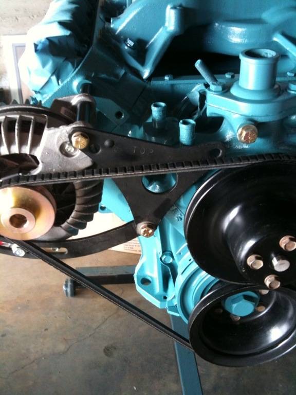

There are minor differences in the early vs late housing but they do have the same bolt pattern to the block. Then there is the very late truck type that has the inlet on the pass side.
The early style pump housing has the upper alternator mounting bracket bolt in a different position. Here you can see a late style bracket on a early style housing - it's a no go!

Thanks HitIt ... that picture really helped me. I've already got enough to do on this car so the cast housing will stay for now.
