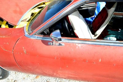

Here are some pics of the aluminium molding im talking about, it wraps all the way around the front of the hood,

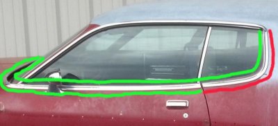

The green shows the trim, the red line is a cast piece and the rest is aluminium i believe.

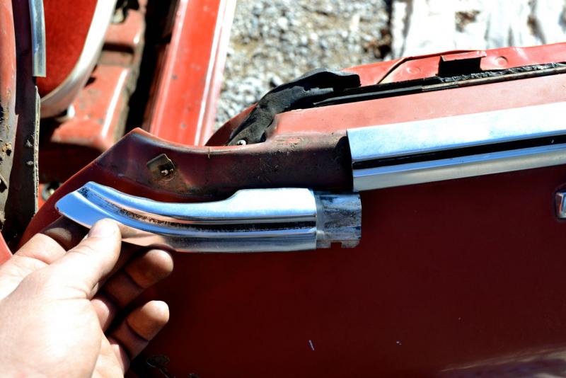

The trim around my rear window has some deep scratches too, looks like a previous owner accidentally hit it with a DA sander.
