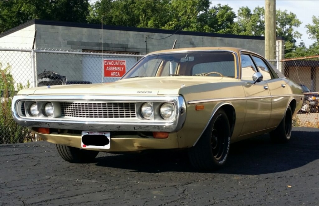

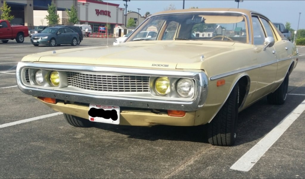

Got bored yesterday, was cruising this site and others, and I stumbled upon something I've always wanted to do, so I up and did it. Painted my high beams yellow, and I really think I like it! Let me know what you guys think, be gentle on me lol here's the before and after.

It's if you like it.
I think it's been decades played-out around Motown with mopars. That, and dog-dishes.
It seems to work well with the yellow car. It is really about what you like, so if you like it, go with it!
i like it !! i want to do mine also, sure do wish you would have taken so pics of how you done it !
Step 1, remove highbeam headlight (self explanatory)
Step 2, clean highbeam with windex and then rubbing alcohol
Step 3, spray with Krylon brand stained glass paint (Hobby Lobby, Michaels, etc, the color I used was called Canary Yellow)
Step 4, BE PATIENT, paint has to dry. I did 3 or 4 light coats
Step 5, spray with 3 to 4 coats of Krylon brand glossy clear coat
Step 6, BE PATIENT, clear coat has to dry
Step 7, reinstall highbeams
Step 8, Enjoy!
Did mine in about 3 hours total

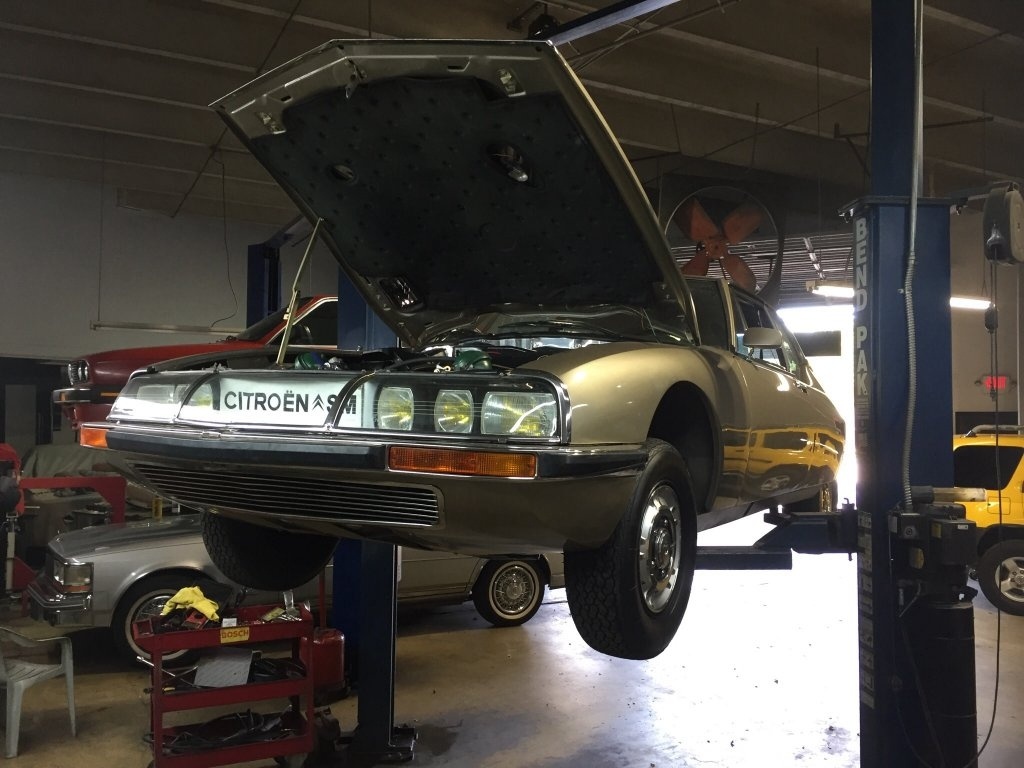

Yellow lights were required in France up until the late 1970's.
Ask me how I know this really obscure fact......
My other car..... It's a French Italian hybrid.
