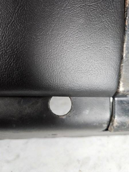

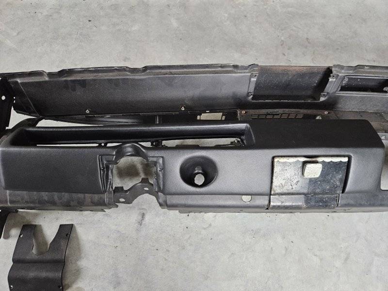

I had just Dashes do a full restoration on a 1969 RR upper, lower, and glovebox lid pads. The upper and glove box came out great. The lower is a whole different story. I first received the lower pad and it has a bunch of weird messed up areas, such as random lumps, lines not being straight, just really weird mess ups. I sent it back. They redid it. It's better... But still not quite right.
I expected perfection on this over $1k lower pad and it's not there. I need to know before I bug them again... Am I being too picky?
New issues:

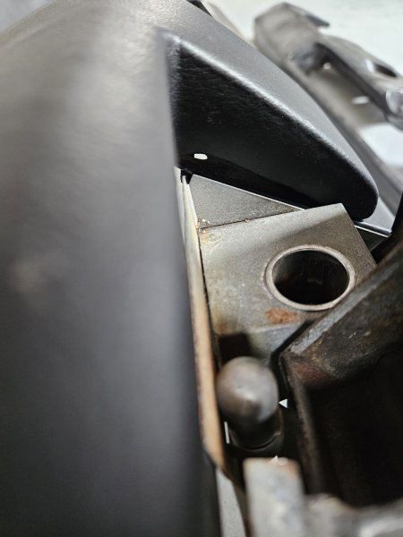

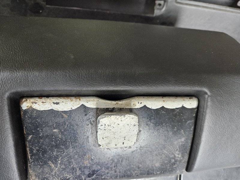

-Atrocious ash tray fitment. Pad is a half inch higher than the door. Top of door hits the pad.
-Column plastic cover lines totally messed up.
-Reverse light hole covered by pad.
They said it was on a test dash and I witnessed it on a video but this just seems like laziness. Am I crazy? Their website gallery seems to show a perfectly redone one so I expected a little better.

Exactly my thoughts as well. This is getting... unprofessional (?) at this point. I've done some more fiddling with it and the biggest issue is the center crease that runs along the whole center horizontally is raised upwards about a quarter of an inch which throws everything off, it's not being held down right like I would think it should be.

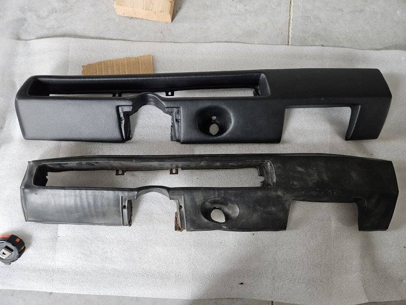

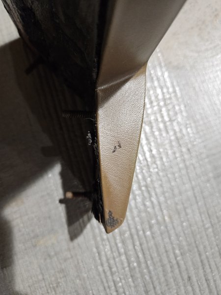

New vs old. As they stated on their site, they do not replicate the stitching. To a casual observer one may notice gentle curves and a general look of soft lines instead of the sharp angles of the original.

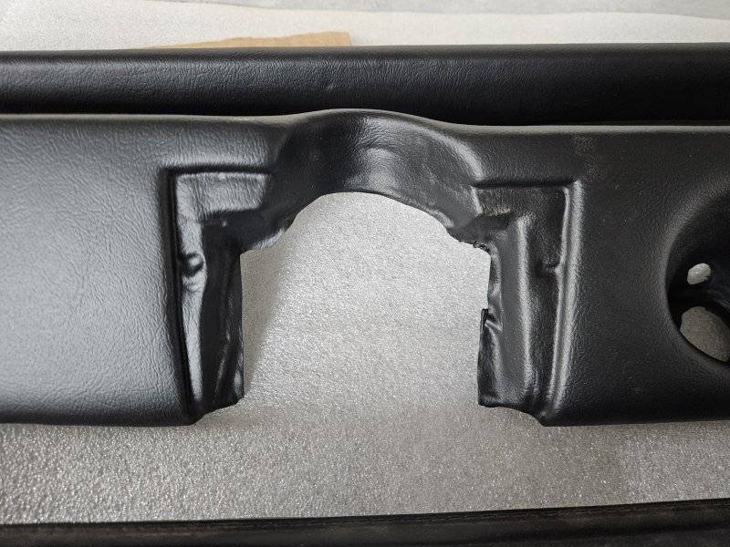

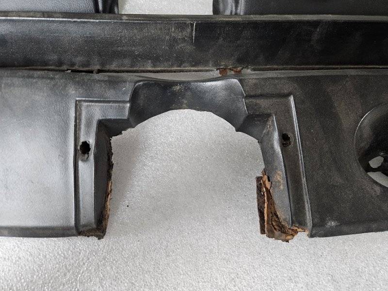

Original vs new steering column cut out. The originals have sharp, straight lines to match the plastic cover plate.

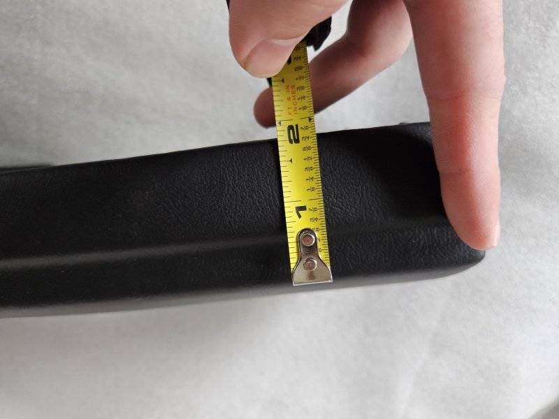

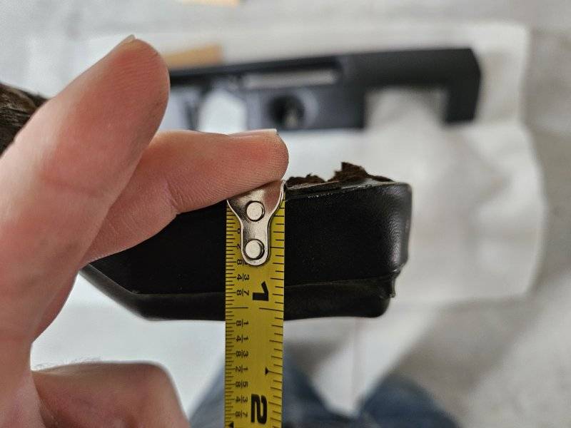

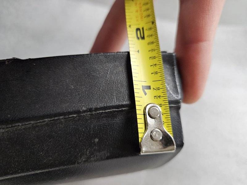

Original is approximately 1.25" thick at top left from metal plate to surface (read second post below, this one shrunk a little bit)
New one measured approximately 1.5".

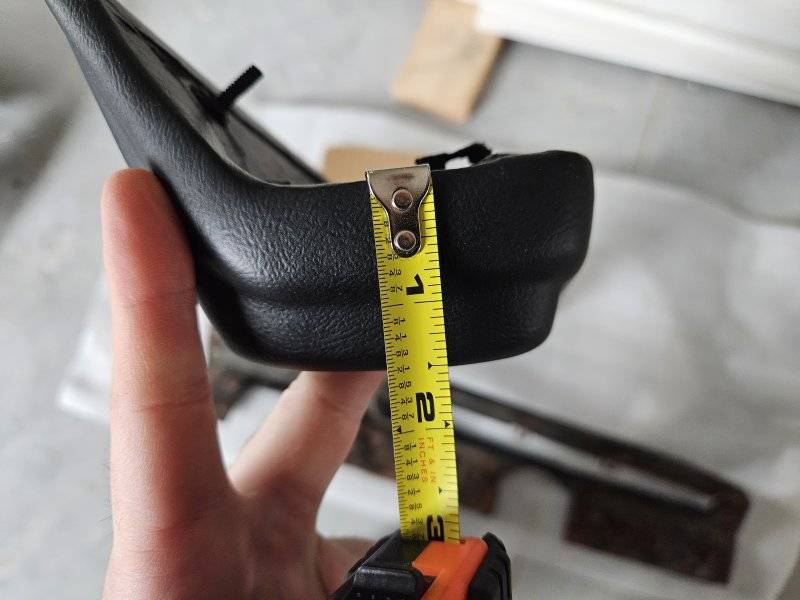

I forget which part this was. I think it was the top right corner. Measured approximately 1.5".
New one measured 1.75" in same location.

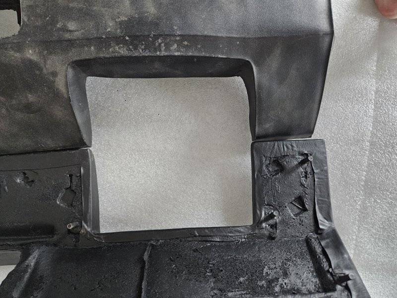

New pad fitment around ash tray. Their test for photos from their dash frame seemed to look better than I could get it to fit on my original frame. Not sure why they had better results than me.
More below.

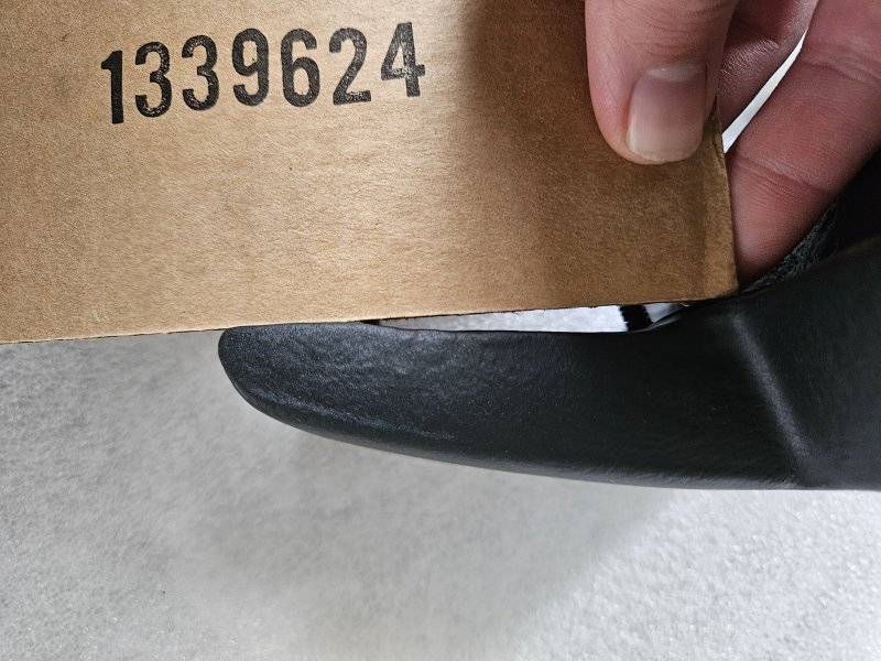

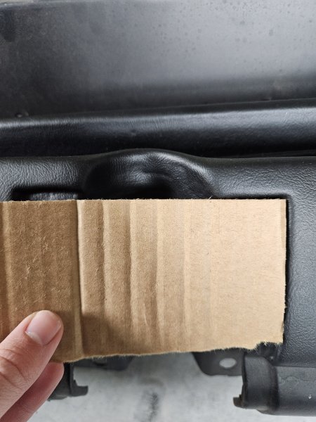

This is the right side of the ash tray. It's supposed to go flat against the dash. It is shown next to a straight edge. The nice one I recently got (detailed below) looks like this:
Thanks to another member here, I acquired a nice original dash pad. I did some measurements on it to see how wrong my original was. The measurement of the left side is off a little, the new dash pad is not that much thicker than a good original which measures a tad below 1.5", maybe 1.4"? The top right corner measurement, however, remained the same, the good original I have measures 1.6" (1.5" on my trashed original), and new one was over 1.75". I am sure all the original pads vary a little bit, so I don't know what's right or wrong.

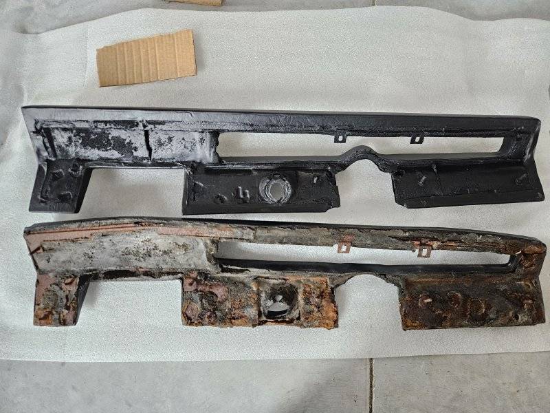

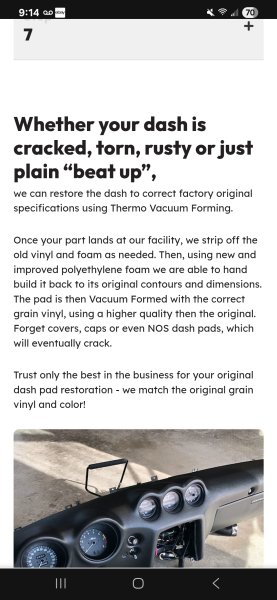

Their website shows another 1969 dash pad and glovebox they redid. It seemed a little nicer than how mine came out. Their website, in my opinion, reads as if the new dash pad will meet original manufacturer specs. I am pretty sure the manufacturer of these originally had a mold in the shape of the dash pad, lined it with stretchable vinyl, placed the metal structure plate on top, heated the mold, and injected expanding foam into the holes in the metal plate (which commonly have foam all over the backside). They were not skinned foam, there was an actual vinyl layer. Just Dashes does it the other way, they construct the foam and then cover with vinyl.
I will leave it up to you to decide if the new pad met factory specs.
