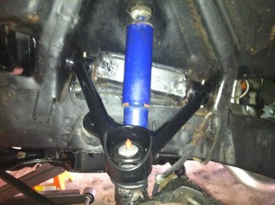

Did the arms come with the ball joints installed? And if not, is it possible to screw the ball joint in from the other side? My main concern is the arm hitting the frame before bumper. If it were me i would take the right arm off, turn it upside down so the ball joint is pointing up, and put it on the left. See how it sits against the bumper. Where its at right now, that arm is gonna smack the frame hard when you drive over bumps or potholes or even going hard enough into turns.
