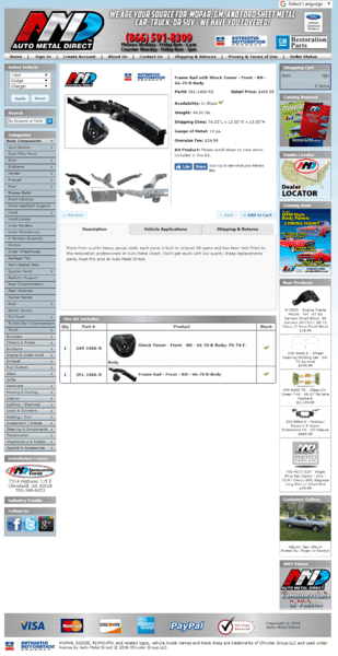

AMD-391-1466-R
Frame Rail, Front Passenger Side, Steel, EDP Coated, Dodge, Plymouth, Each
(Mfr. #: 391-1466-R)

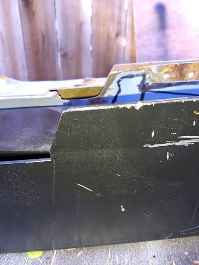

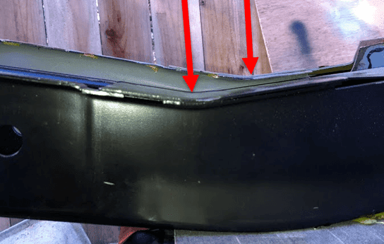

If the frame rail is all the way back against the perpendicular "transmission" frame rail, like the old one and the drive side frame rail, then the curved part of the frame rail is in the wrong location and puts the frame rail lower than the other side and is about 1 inch short of the radiator support, etc.
If I pull the frame rail away from the transmission frame, then I can match the curve of the firewall and the frame rail mates up properly to the radiator support, but is an inch short of the transmission frame rail.
This picture shows the gap when I properly line up the curve of frame rail with curve of firewall, and match up with radiator support. I would have to cut and weld more steel here to make this work. (see attached 1.jpg)
This picture shows the improper curve matching when I slide frame rail back towards transmission frame (see attached 2.png)

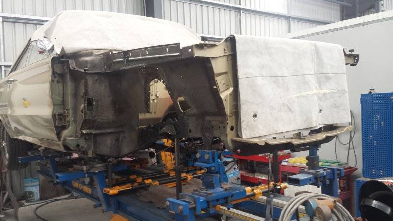

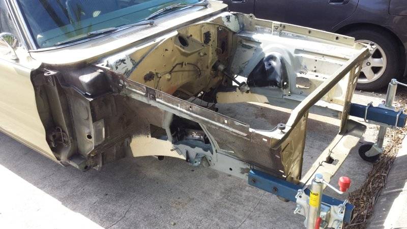

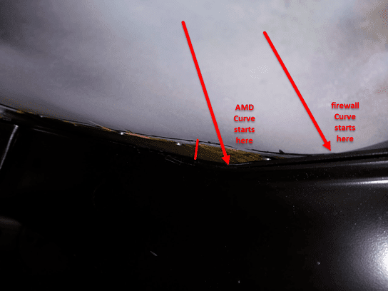

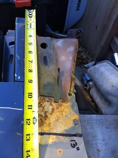

These pictures shows the 2 frame rails side by side starting at the same point. See where the AMD starts before the original? (see attached 3.png & 4.jpg)

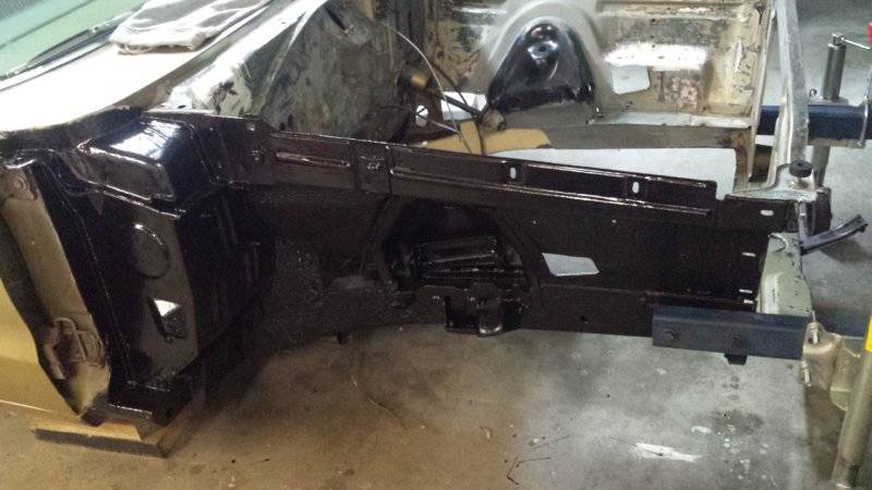

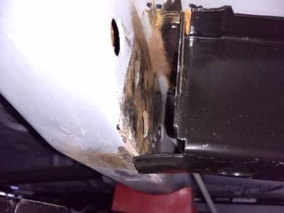

Here is the big difference with the starting point of the firewall curve.
(see attached 5.jpg & 6.jpg)
