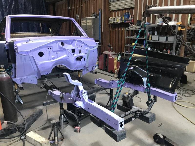

You need to measure everything carefully and put the chassis on a jig if possible. The radiator support stays on which helps keep everything square to a degree, but things will still move.

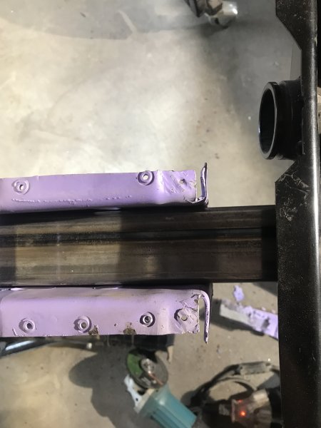

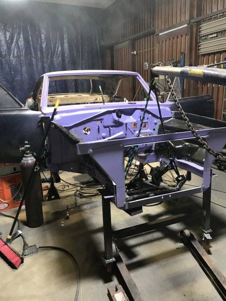

I used my k member for reference and also welded a piece of square tube to the tbar crossmember. Either 1 1/2 or 2”. I think 2”. But it was good to locate the back of the rail and gave me some more to weld to on the inside. (Square tube to inside of frame rail). I did both on a body cuda. I like to use a 90* laser on the floor too. Draw lines on the floor where the laser hits and label what should go where for install. If you can drill the spot welds super accurate and not mangle the inner when you do, you can do that, or use a bandfile on the old rail, but it might be a fools errand where the rail is doubled. I did mine with no floor or motor/trans.
I guess I also used a rolling rack I made that attaches with the bumper bolts
