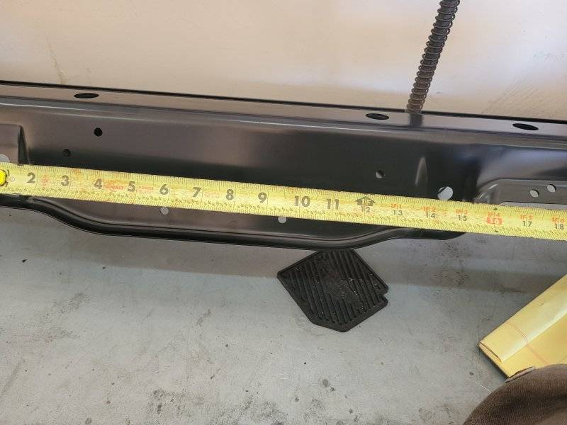

Hello everyone, I'm finally starting my 68 charger project, have a question. The original rear cross member holes to mount the shocks are measuring center hole to center 14 1/8 new amd part number 860-1466 holes are 15 inches...unfortunately they are closed today. AMD says fits all B-body...has anyone run into this? Will this affect exhaust or any other issues. Thanks for all the help!
Your tape makes it look like 14 1/2. I doubt it will make any difference.
My guess clearance wise. 7/16" at the top should be able to be accommodated, exhaust being your first concern if any,
Suspension kinematics, negligible.
Yep you will have to call AMD I think it will be fine.
I don't see 15" inches c to c....... I see approx 14 3/8
Thanks the photo with tape measure was the best I could get 1 handed...but it does measure 15 inches center to center
Measure the shock mounting holes on the other side, they look like they’re at an angle.
