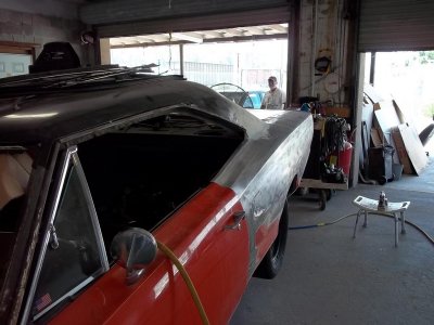

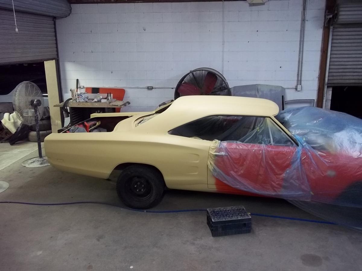

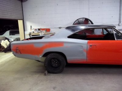

Couldnt believe how good it went on. The fit is perfect!!

I have used a good bit of their stuff with no issues.AMD quality is top notch.
Looks good! AMD makes some pretty decent stuff compared to the other big companys selling sheetmetal. Most of it needs some work/tweeking to fit right, but by no means like the other guys
Good to know because I have 2 full 1/4s and a roof skin from AMD to install on my buddies 69 RR.
What did you use on the joint from roof skin to 1/4 panel?
The roof flange was punched out with 5/16" holes about 1" apart then every other one was filled "spot weld style". each one was cooled with compressed air until cold. over and over until all were filled. A small stitch weld was used at each end just like the factory skin I pulled off. To fill the void that was normally filled with lead I used Duraglass. It doesn't absorb moisture and I'v never had any issues using it over clean metal.
