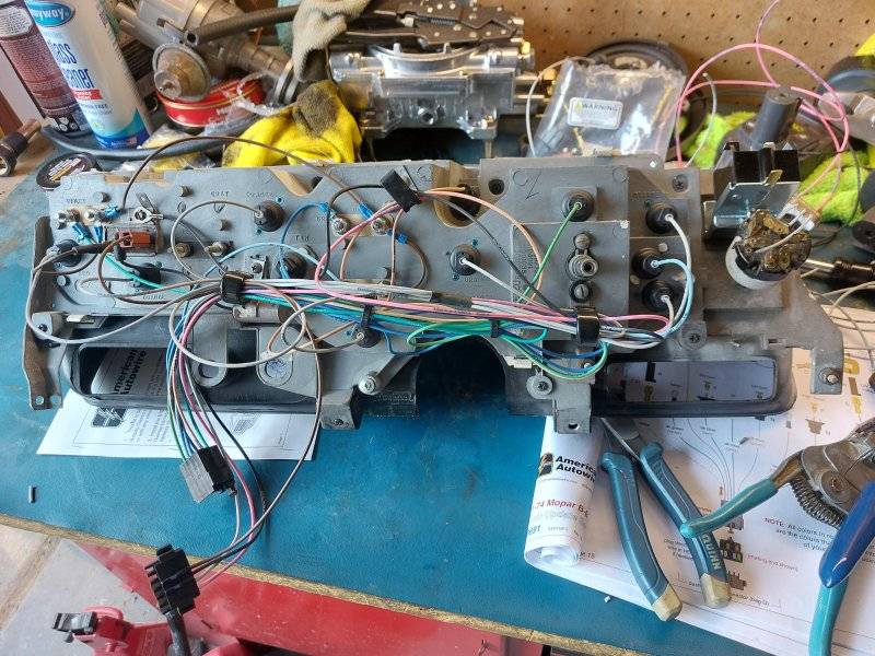

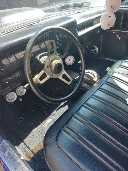

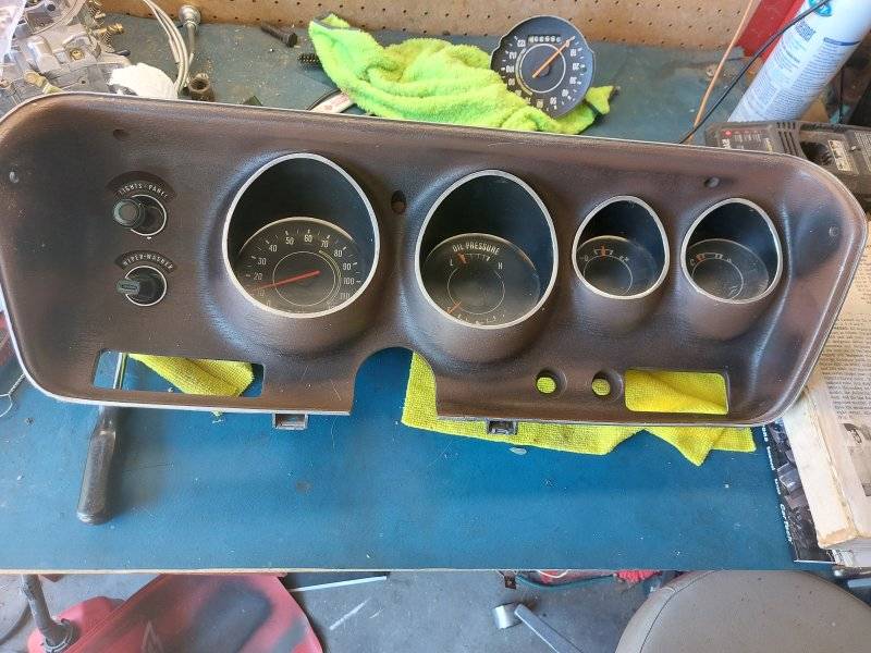

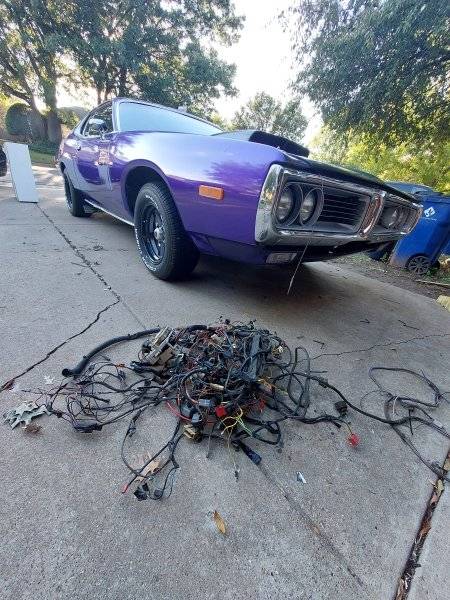

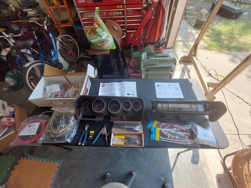

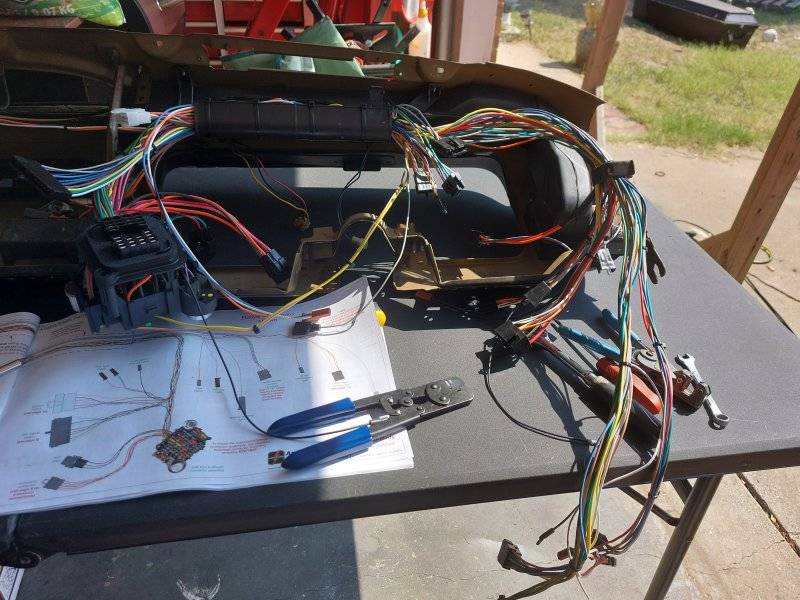

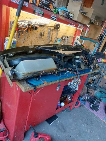

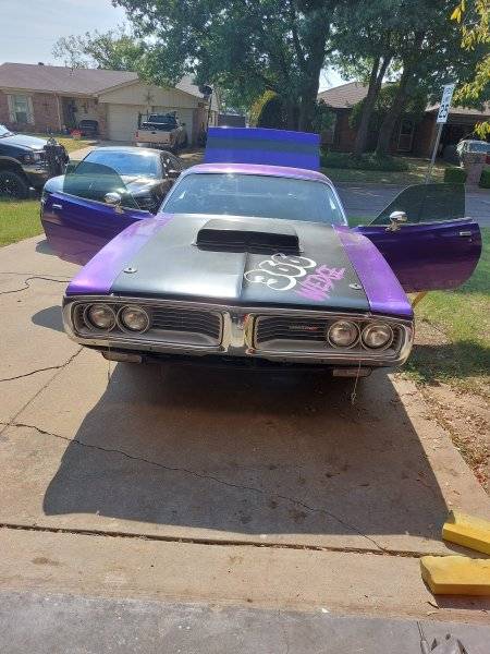

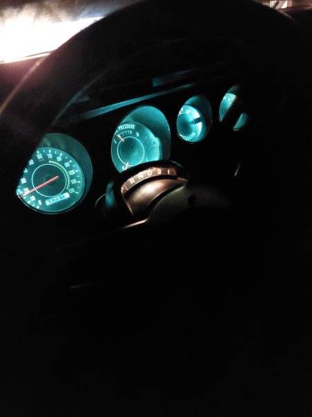

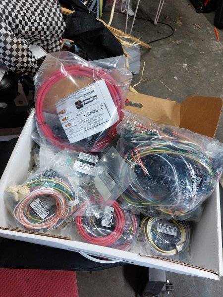

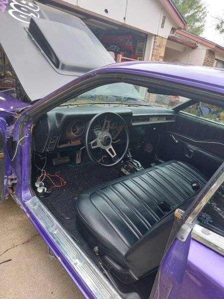

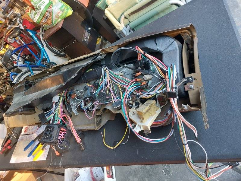

This weekend I started a project with my 1973 Dodge Charger.. i had already by passed the ammeter, but i wanted to convert to rallye gauges and instead of putting a 50 yr old harness back in i went ahead and started a wiring upgrade... the kit is very detailed and actually not to bad on directions.. so far i have the cluster, dash and ignition done.. next up is to install the dash and start on the rear harness... then on to ignition, charging and front lights... this kit also eliminates the ammeter and converts to a one wire which i like... it also eliminates the key in buzzer, door buzzer and seatbelt light. i will post more as i complete more..... does anyone have a neutral safety switch pigtail, oil pressure sending unit and water temp sending unit they would like to part with?

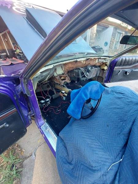

i have rewired the dash, converted to Rallye gauges, wired rear lights, front lights... now I'm down to engine harness and ignition... which i will be replacing the and the ballast with a MSD Streetfire box and i have to find me a 1 wire alternator....

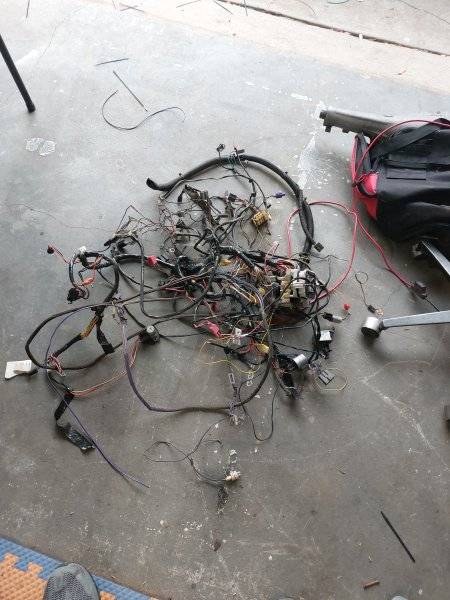

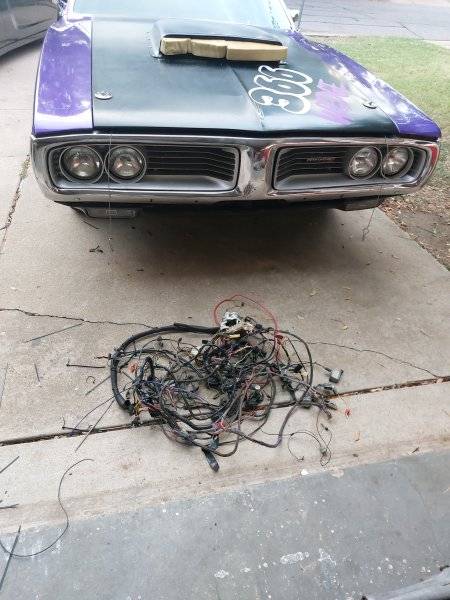

American Autowire Harness is installed and everything works flawless except wiper motor.. im pretty sure it is a ground issue.. i will figure it out and if not i will come here for knowledge.... anyways i have about 55 hrs total invested in removing old wiring, dash and install new wires and crimping a lot of the ends...The great thing about this harness is that it completely eliminates the Ammeter and converts to a single wire alternator.. i still need a voltmeter gauge and the American autowire heat/ac secondary harness and a few bulbs. .. While i was in there i went ahead took out all the ignition and put in a MSD Street fire box as well.... This has been a fun adventure...

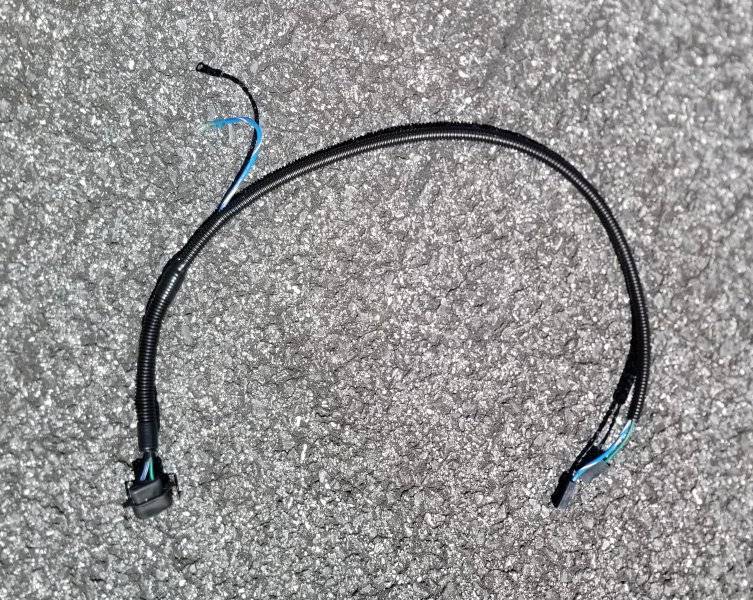

You don't have to use a one-wire alternator. Just use a voltage regulator pigtail and wire the green lead to a field terminal on a regular Mopar alternator and the blue lead to ignition power and to the other field terminal. I put the voltage regulator on the inner fender apron below and behind the horns.
