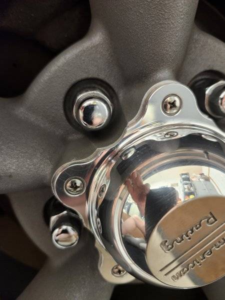

The wheel has a notch too. Are those 5 on 4" ?
5 on 4.5,; 6" wheels.The wheel has a notch too. Are those 5 on 4" ?

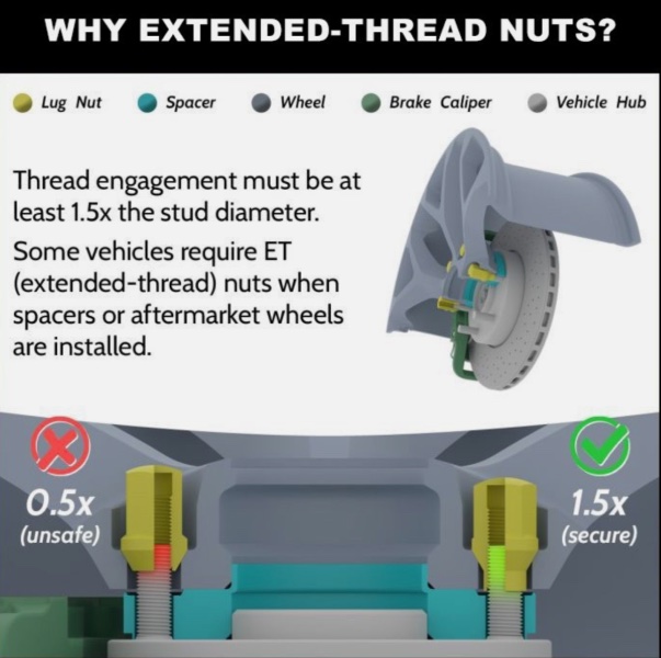

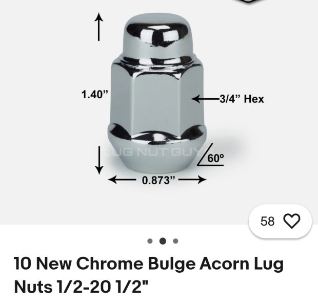

I know this is an older thread but those are not the correct lug nuts for torq thrusts. You need to have extended thread nuts or else the nut is barely grabbing but you can’t see this because of the closed end of the nut.The same exact lugs nuts I used.
