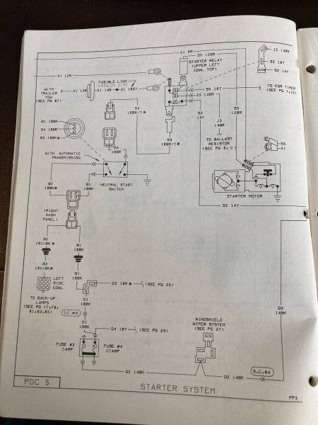

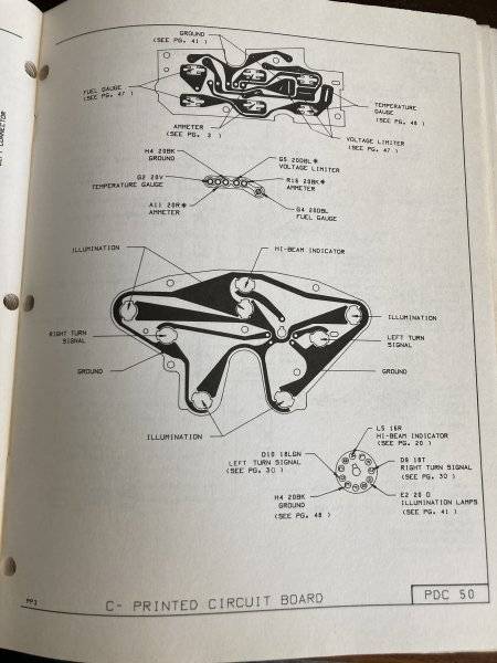

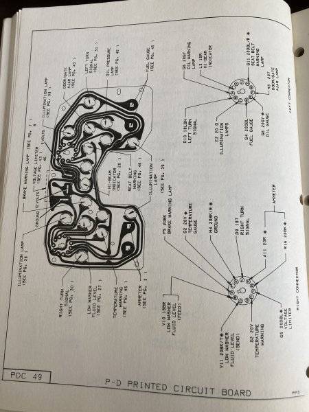

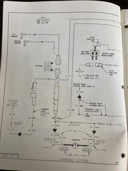

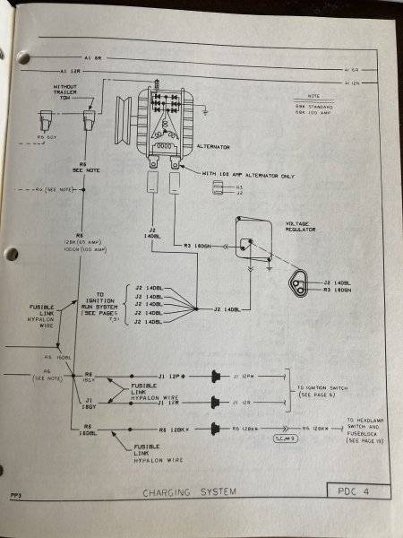

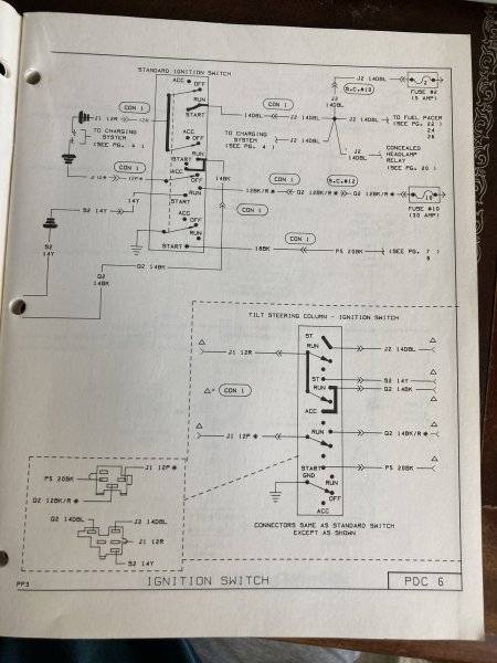

So I wanted to share...not sure if I'll ever do this with a newer ammeter. But, since I was not able to find a 77 Monaco service manual on mymopar, I bought one off eBay. It has the factory wiring diagram with the newer shunt that Nacho mentions above. I wanted to include that section from the manual just because I find it VERY interesting! Again, who knows if I'll do this but nice to have the info from the factory.
View attachment 1390564View attachment 1390565View attachment 1390566View attachment 1390567View attachment 1390568View attachment 1390569View attachment 1390570
