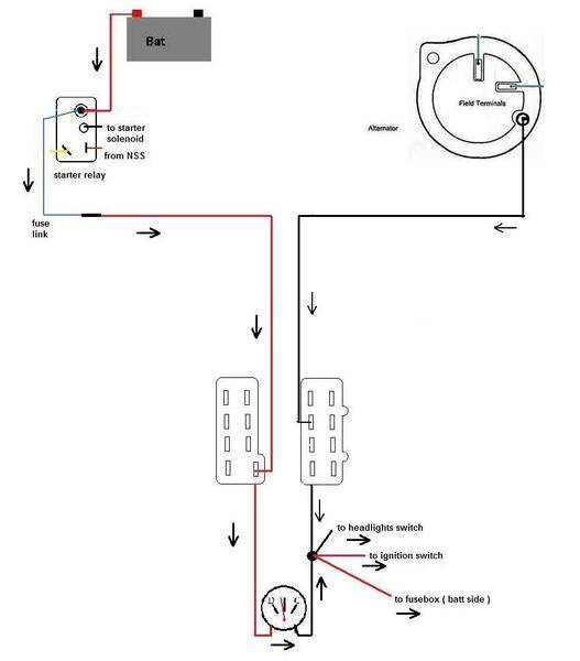

On the best charge status and really nice alt, with a fully charged batt you should get this ( bulkhead disposition based on 71/74s )

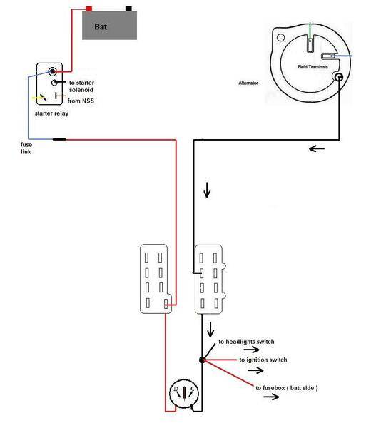

But if batt is slightly discharged and alt is able to source the batt load request along with the car demands, this should be the reading ( and the loads flow )

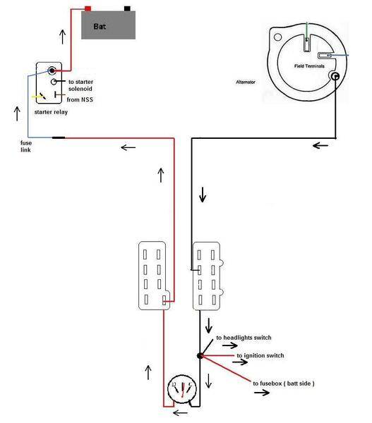

If the alt is not able to source all the car request, the batt will supply what is missing and this is the reading and load flow ( tipical on Mopars with poor stock loads capacity at low RPMs )

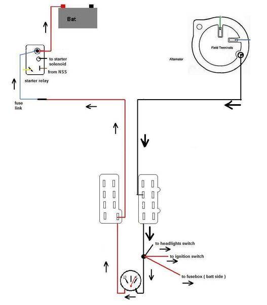

Then when you give throttle after the previous status, you get this:
Now you know what the ammeter readings mean
AMMOUNT OF LOAD IS REPRESENTED BY THE ARROWS THICKNESS
