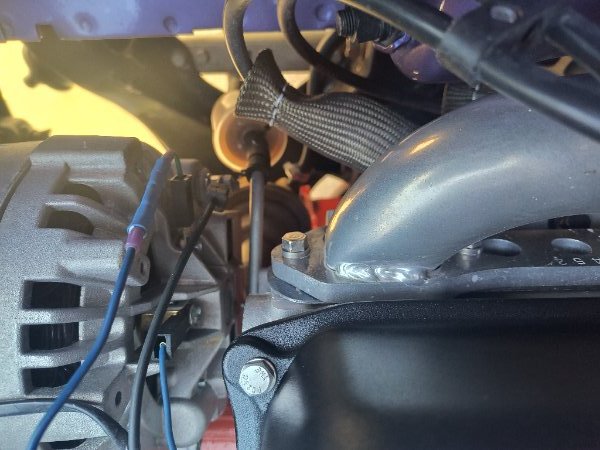

I have a pic here of the alt and I did double check the ground, metal to metal, surfaces. It sure looks good with no paint interference.

That is a 2 wire alternator. I see the one wire has been spliced. One wire should be hot with the key on (factory blue wire). The other is normally green and feeds from the regulator. The regulator should be the flat style with the triangle shaped plug. If the ground at the battery and the regulator need to be close. What I mean is if the regulator ground is weak it will command the alternator to charge higher.

It sounds like you're saying...build a ground strap to run from the back of the block and maybe even ground on the same screw as the regulator, to have it as close as possible? It is the usual chrome, flat style with the triangle plug with 2 pins.
A ground to the battery would be the best. However these systems ran from the factory with the regulator just screwed to the firewall. So as long as it's bolted clean, tight, and the body has a good ground to the battery (usually right at the core support from the negative cable) it'll function. That leaves three posibilities. The green wire is pinched to ground. The regulator is bad. Or one of the brushes is grounded. Sometimes one brush is grounded so the newer style regulator will function with a one wire system. It would have to be the brush connected to the green wire, otherwise it would've smoked the blue wire by a direct short to ground.
