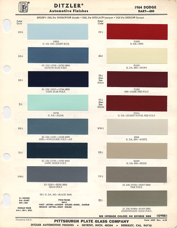

Hi Guys, I'm in Ireland where I'm restoring a right-hand drive '64 Polara sedan. After 3 years it's ready for paint but I really need the mix formula for Anniversary Gold. I didn't save a sample as I was originally going to paint it a deeper gold with more 'flake.
Can anyone help with this ?

1964 Dodge Polara Anniversary Gold:
Paint code: Z
Ditzler: 81416
Dupont: 4520L, 4520, 181-96963
This is what the site listed:
G B Y 1964 Dodge Dodge Anniversary Gold Z C 81416 4520L, 4520, 181-96963 9309 A1678 880 only
G B Y 1964 Dodge Dodge Anniversary Gold Z C 81404 4519L, 4519, 181-96962 A1677 not 880
This is more info:
Ditzler PPG: 81416
Dupont: 4520L, 4520, 9309
ACME-ROGERS: 181-96963
RM BASE: A1678
This is from Ditzler
"Just GOOGLE Ditzler classic car paint codes"
It appears to be DITZLER ZZ1

Thank you so much for that super-quick reply, I'm gonna forward that on to my paint guy.

The info you supplied was of limited use as we don't have DuPont and the other brands mentioned, my bodyman has been using a brand called Standox for decades and wouldn't change as he'd have to change thinners and primers.
However when I forwarded your post it sparked him into contacting an old-timer working at Standox in England who
located the mix code for Anniversary Gold, I saw a sample yesterday and it's spot-on. My car should see paint in the next few days, when it does I'll post pics. The ONLY all-American car show in Ireland is on April 26th at Kilbeggan,
County Meath and I'm hoping to have it ready for then.
