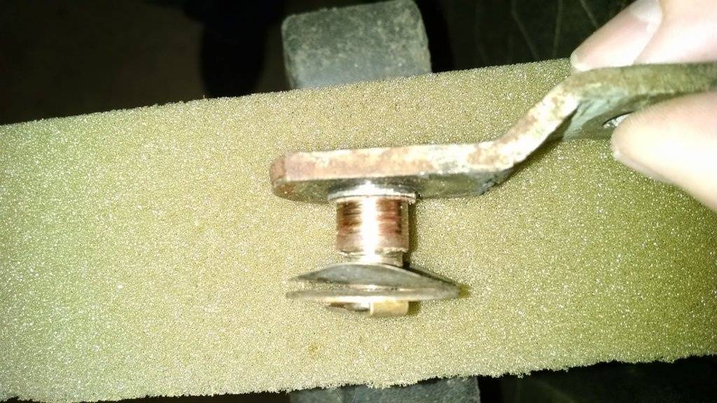

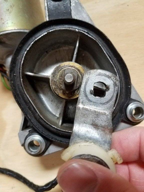

I recently purchased a NOS 3-speed wiper motor (part#2889982 if I remember correctly) for my '69 Charger. I know it isn't the correct part number but was told it would fit and function. I then obtained the appropriate crank arm (2822273) with bushing, etc. Problem is the slot in the crank arm isn't near big enough to slide onto the stud on the wiper motor. This thing is driving me crazy! The ends on the motor stud appear rounded with flat sides. The crank arm appears to have 1 rounded end, a flat end, and flat sides. I'm more than willing to do some sculpting on the slot if necessary, but there must be a proper crank arm out there somewhere. I attached a (poor) photo to illustrate. Any help is appreciated.

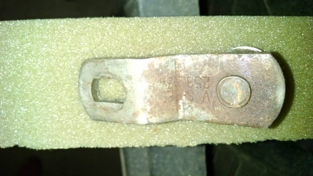

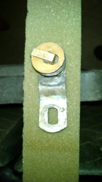

Here is that correct 3 speed arm. It utilizes a different bushing which I do not have.
The slot on your arm appears to be the correct size that would fit the stud on my motor. Is there a part number on it?
I got it. 2580934. I don't know whether to get that crank or just bite the bullet and get a '69 wiper motor. I was told the '68 would work but with all of this part drama I'm not sure. Bulkhead wiring appears to be the same. The drive area of the motor where the crank attaches appears different between '68 and '69.
