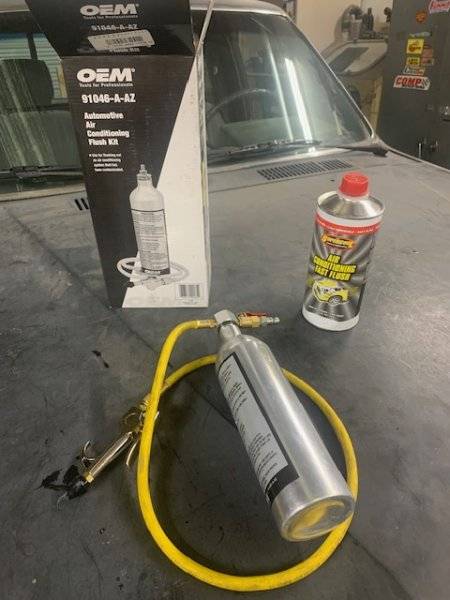

So, first, since very few people own a A/C system flushing tool these days... Auto Zone has one in their loaner tool program... You give them $75 & they give you the tool... Return the tool in a timely manner & you get your $75 back... They don't typically sell the flushing solvent so they aren't making a dime... Thanks Auto Zone...
This time I ordered the flush solvent through Amazon... $14...
So, you have the tool & the solvent... But the tool isn't very effective cause the solvent is more like light oil or paint thinner than a hot solvent...

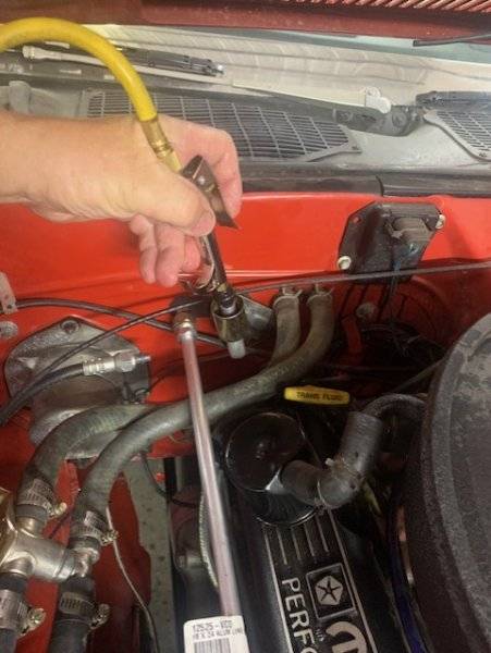

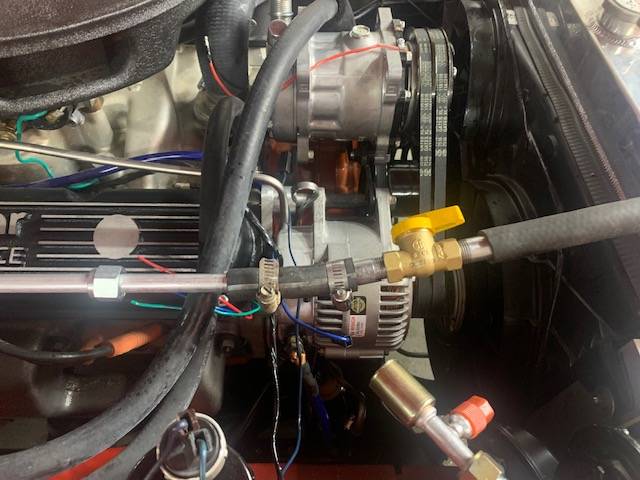

I add a ball valve to the discharge side of the component I'm flushing, that allows me to pressurize the component being flushed by opening both the inlet ball valve the the gun trigger with the rubber nozzle firmly sealed to the inlet port... I let the pressure push the solvent into the component & fully pressurize the component withe the discharge valve closed... Then I open the discharge forcing a rapid blast of solvent & air... I open & close the discharge valve a few times, causing solvent to blast through the component... Then I reverse the connections & flush the other way... And finally back the same way... By the time you've flushed three-four times the solvent is coming out very clean..
Discharge valve
Inlet gun

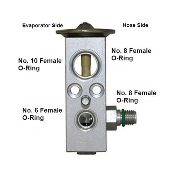

These systems don't use an orifice tube... They have an expansion valve... But yeah you can flush evaporators, condensers, hoses & manifolds... Expansion valves tend to close when outside the system so you can pop the filter screen & blow out any excess oil or debris... But most times I replace the valve with one calibrated for R134... The Receiver/Dryer definitely gets replaced.. And you can't flush the compressor, all you can do is drain it... But when I'm doing these conversions I replace the RV-2 with a new Sanden... So new compressor, receiver/dryer, expansion valve & reworks hoses... On this car I'm also changing out the condenser to a triple pass design...
