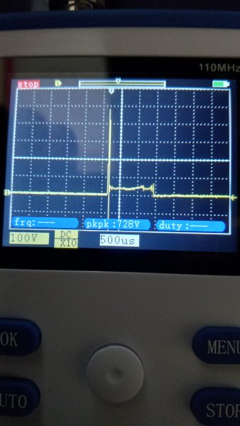

Here is my first wave form I got off my coil hooked up to the negative side.
The time frames and voltage scales all determine what you see on the screen and accuracy of the readings ?
People that know how to use these will be able to tell if I have my settings correct from my pics.
Just looking for some input.
Looks good to me. You have it triggered and capturing a waveform that's 728v p-p.
You can change the time base and zoom in on the ringing.

What is the 728v p-p mean ?

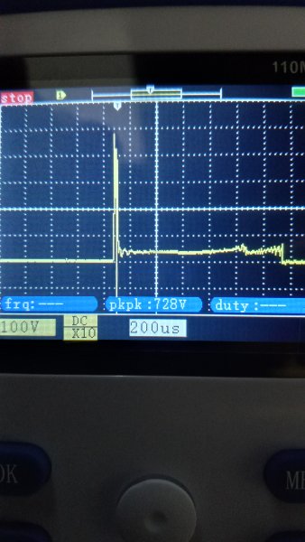

My understanding is that I have it set on 100v scale so each square is 100v . My spike or fire of the plug is about 400+ volts would that be correct . I scaled the time in 2 different patterns 200 and 500us.
How much is a US.
Just liken vertical squares being 100v each , going horizontal the squares would equal 200 or 500 us per square ?
You are correct. Each vertical division is 100V per your scale. The "Vp-p" is volts peak to peak. A us is microsecond which is 1*10e-6 seconds. I'm impressed you picked this up easily.

So what you see is decent info. But what do you want to see? The discharge pulse peak voltage? If so, you should be using the trigger function. Start high and then bring it down slowly till it triggers. That way you don't miss the peaks.

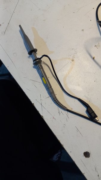

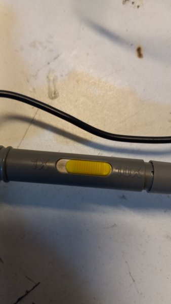

I belive that is the correct probe to be using ?
What I was really interested in was dwell and coil saturation. From what I read, I don't really see that in my wave signal. Should there not be a drop in voltage as the primary charges , and then if a slight rise if gets full saturated and limiter kicks in ? Then the big spike as the " switch " opens and the field collapse?

Also..... why do I have such a huge negative .
I get it now pkpk = peak to peak duh haha
So I'm up 400 volts then negative 300v ? How is that possible ? Should it not hit 0 volts and stop?

Yes - 10x probe so your scope is set properly. For this measurement, its a good choice.
I don't believe that you are reading negative. I think your trace is not set at the middle of the the screen which would be zero. What you have is fine. I believe all of your reading is positive.
However the screen shot confuses me. The trace moves from left to right so the high voltage pulse comes first then the much longer lower pulse, then the pulse goes away. So that would mean the HV pulse happens when the voltage hits the coil not when it shuts the voltage off. That does not really make sense to me. Maybe someone else knows.
Also change your time scale to a longer time period like 5 ms to see multiple firings just to play with it.

Ok. makes sense now. Brain cramp. I forgot that the negative side gets grounded. So the spike is when the ground opens the the second pulse is the spark duration.

Actually you have a probe that can be set to 1X or 10X. You have it set for 10X which is what your scope is set for. Voltage numbers will be wrong if the scope is set for something other than the probe you are using.
