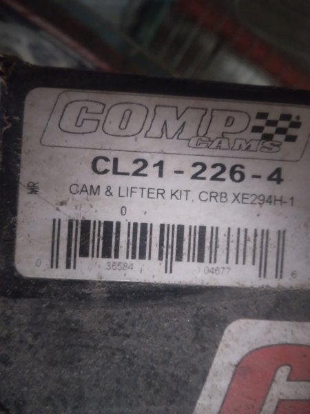

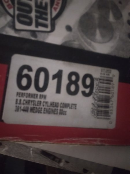

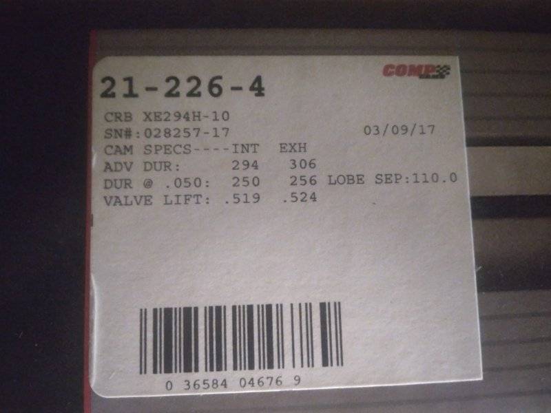

I was going through my garage and I have some parts I purchased back in 2018 with plans to hop up my old 440, what I am wondering is if this cam amd rocker assembly is to aggressive for a street car and more set up for a street strip leaning towards strip setup i would like to get more power down but still be able to use power brakes, with the below list of parts would I be making this more of a strip car?
Comp Cams 21-226-4
XE294-10
028247-17
INT. EXH
ADV DUR. 294. 306
DUR @.050 250. 256
VLV LIFT. .519. .524
60189 Edelbrock 88cc Cylinder heads
1.6 Ratio rocker arms 440 source
And misc. Hardware
200-1046
I am looking for something that has power to break the tires loose but is still drivable for a cruise with power brakes. Did I over buy back then?

Its not likely to have enough vacuum to power the brakes.
If not enough vacuum what specs would I be looking for, to get enough vacuum for the brake booster?
Results may vary but I've always been told 230* @ .50 for good brakes with hyd flat tappet. That's a bunch milder than what you have
A stock 440 automatic would easily and effortlessly do what you want.
I use an external vaccum pump to power my power front discs on the 70 problem solved for me. .484 cam MP thought they once said anything under .474 was good for factory setup but could be wrong
250° at .050, and power brakes will not play well together.
If you wanna keep the power brakes (why?) Id look at cams with 230° at .050, or less. (Preferably, less!).
I have never had power brakes on a hot rod in fifty years.
I thought about manual breaks but wanted the power and learned shortly after that my cam choice for my build didn’t provide for my power brake needs but fixed the issue later with the vaccum pump. Manual for me no issue but for the wife it would’ve been so vaccum pump I went plus my old *** wanted power breaks lol
That cam would be a bit tamer in a motor with a 4.15 or 4.25 stroke. Still rowdy mind you but more manageable. I ran a 246* intake @ .050 hyd with a 3.91 stroke and my power brakes were fine.
One size smaller would be manageable but two sizes would be better matched to a cruiser and still capable of 500hp with Edelbrock heads. The XE274 is a good street cam and the XE 284 is one step hotter.More of a 550hp cam with good heads.

Edelbrock Performer RPM Cylinder Head for Big Block Chrysler
Part Number: 350-60189

Do you have headers? The E streets will up the compression some 75cc vs 88cc. They dont fit on some headers wo a hammer. Had the heads off? Are they flat tops or do they have a dish? Flat top is really, really low compression, dished piston even worse. We have a rv 440 similiar in great shape, we dropped in oem used 68-70 pistons. I suggest looking at smaller cams like a comp 268XE, voodoo 702 or comparable in size from Hughes. I probably would not get hughes whiplash if your wanting to run power brakes.
Heads have not come off yet, still boxed on the shelf (Edelbrock) iron heads still on motor in the vehicle, i was planning on removing this fall, ok so a lighter cam understood, then i will probably be placing the rockers, shims, spacers, and camshaft for sale then. Thank you for the input! do you by chance know what the original cylinder head volume was? 88CC or larger/ smaller?
452s run about 90cc.
Ok, i will see what heads are on it and see what block information i have and do some digging, thank you!
