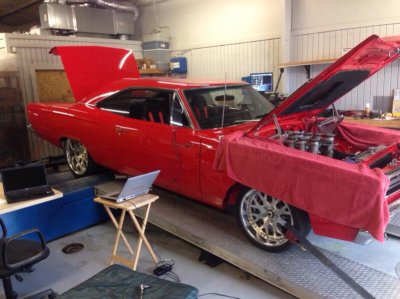

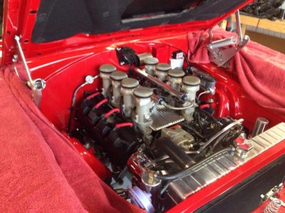

I spent my day tuning the beautiful beast. Gen3 Hemi with individual throttle bodies and AEM stand alone EFI

looking real good and that's a nice clean install ,how did the tune go :thinker:
Good, it was an AEM stand alone ECM with a file from plum floored creations. It was TERRIBLE when we started. It wouldnt run. I had to build a new file from scratch. I basically DOUBLED the numbers it made on their tune. It left making about 400 wheel horserpower on my mustang dyno. It was having trouble with the ITB setup not balancing and not going completely to wide open throttle. I think I could have got another 40-60 if we could have gotten the throttle bodies to open up all the way.
Love the individual TB's. I miss my RR..:sad5::sad5:
