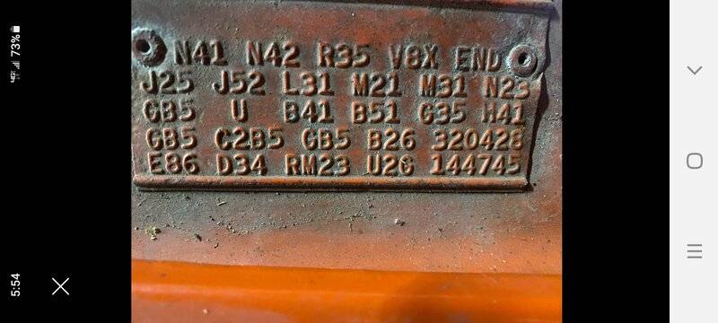

There is a individual here locally that is advertising a 72 roadrunner gtx for sale. Is there supposed to be a code on the fender tag designating gtx option?

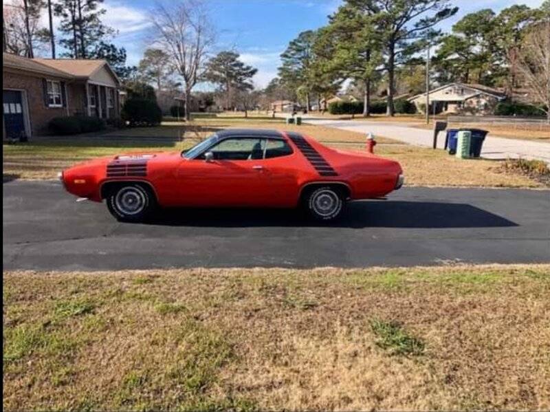

Well thanks I just wanted to check as there are a few things that don't match the fender tag. Tag says blue color with blue bench seat interior. The car Is red with black bucket seats and floor shift and half vinyl top.
Tag is riveted instead of screwed???
H41 strat-o-vent
Given the major discrepancies with the color and trim and the tag is riveted on meaning someone has messed with it it...be sure to check the body numbers to the tag. Does the tag match the VIN plate?

Could have been painted by someone that liked V2/F5 more than B5.
Buckets and console are easy to swap.
Check the body numbers.
Might be a good deal.
No partial vinyl tops on that year GTX if I recall correctly. The choice was no vinyl top or full vinyl top for the GTX.

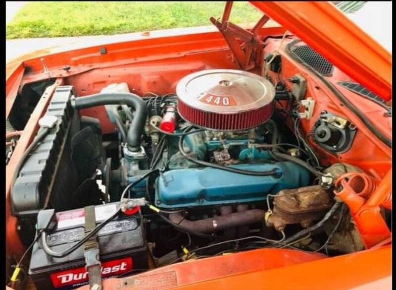

Is that even the correct 440 valve cover for a '72 road runner GTX??

Yes it is.
