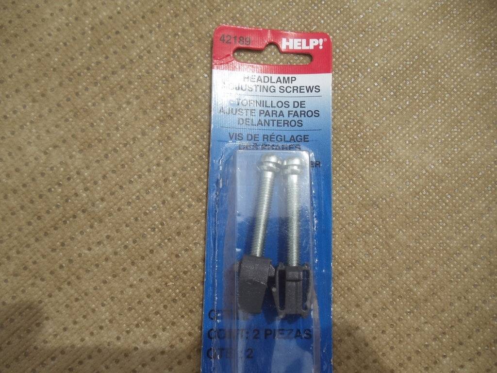

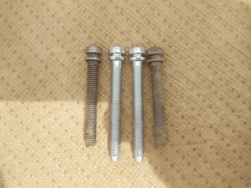

The Dorman/Help headlamp adjusting screws (#42189) for my '72 SSP are a joke. There are three discrepancies which forced me to use the factory screws over again, although the plastic "nuts" were usable and actually that is all I needed to get things back together:
a) wrong length (this may or may not be a problem?)
b) The slot is way too small for the headlamp bucket tab to slide into (I tried)
c) The 45 degree chamfer is in the wrong place, pointing down toward the threads of the screw rather than up toward the slot. Can you believe it?
P.S. Made in China, thank you very much.
P.S. Made in China, thank you very much. View attachment 426777 View attachment 426778
