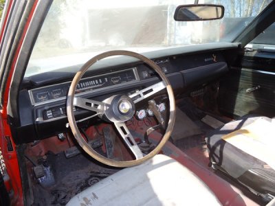

I would like to restore the wood wheel in my 69RR. How do you remove the plastic without busting anything? I see there are three holes in the back but not sure how it is fastened?

Sorry Lionized I should have been more specific! I have the wheel off I would like to remove the plastic ring which used to look like wood grain around the steering wheel so I can restore. I thought it would be much easier without having to mask.
Yeah, that'll be way too much work. Clean all of your cracks/gaps with a dremel tool to give them some bite then fill with two part epoxy putty. You'll want the old material there to match what you are going to repair.
