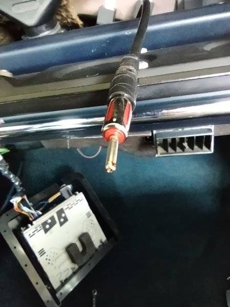

Anybody ever tried one of these? It is referred to as solderless.
While the shield (copper braid) can be solderless, the center conductor will always be soldered. The connector crimps the braid, but the center conductor will just sit inside the hollow center pin without being soldered.

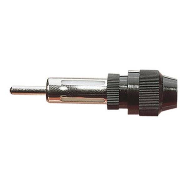

I called the local stereo supply place and he sold this package of plugs, 5 for 5 bucks. He said it would be simple to replace. We shall see.
Yup..
U can solder on a replacement motorola plug, but it takes special attention and skill for soldering the outside ground shield and very tiny center conductor wire..

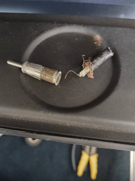

Okay I had a go at it. This is what was left of the original plug. I stripped the cover and exposed the centre core. The wire inside is tiny. I folded back the outer wire sheathing so it would contact the outside shell. I ran the tiny centre wire through the end of the pin and soldered it. The new plugs came with a vinyl sleeve and I added some tape to secure it. The result is the radio works perfectly. I pick up more stations than on my new car.
