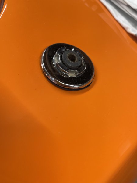

My car never had the mast but had the original base as pictured. How does/did the mast get inserted in the holder? Is there threads deeper in there or is it just a press fit or am I missing another part?
Should be a rubber grommet that sets on the painted surface; no metal to metal contact. Antenna screws in.

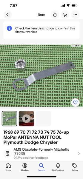

I know there’s a special castle wrench for this but was wondering what the regular guy would use so I don’t mar up anything. I made a custom neoprene washer that works well.
I use large needle nose pliers with a rag or tape wrapped around the tips to tighten them down. Worked well for many years.
I just gently tap a large, flat blade screw driver, alternating 180 degrees.
I would just buy the cheap socket that works. I hate marks and paint scratches. One slip and the tool seems cheap. Tool can be found in the 10 buck range.

Thing is you can always tighten it fully later. This tool will always be an asset. I have had mine since 1972.
There’s a cheap ( like 12.00 ) tool on eBay that I love that I own and now it’s the community antenna Mopar tool in my town lol
I just tapped it in like YY1 suggested. Was carful not to miss. All is in and tight. Thanks for the suggestions guys!
